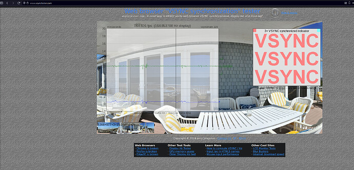

RTX 3080, MATE desktop, X11. Dual monitor setup. 165hz and 144hz, forcecomp enabled with __GL_SYNC_DISPLAY_DEVICE used to sync to highest refresh monitor.
Huge amounts of frameskips when the firmware is loaded:
disabling the firmware with kernel boot parameter
nvidia.NVreg_EnableGpuFirmware=0
fixes the issue:

UPD: I did some additional checking with NVreg_EnableGpuFirmware=0 and the problem does exist, I just can’t see it without a synthetic test.And it looks like this test doesn’t work in firefox.
screenshot
