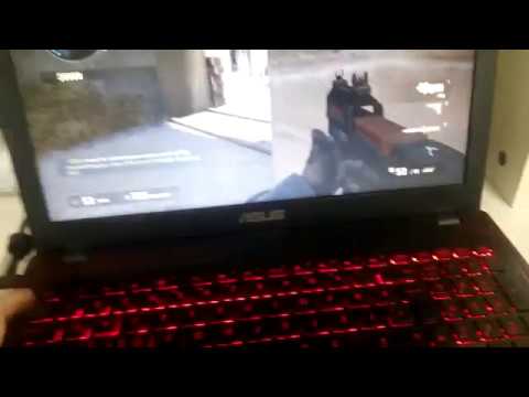

Thing is , it looks like it is causing a memory leak and because of that i can’t even enter tty to provide you these outputs. At least i recorded a video which shows how serious that hardlock is.
https://youtu.be/mvr5aqcIQpQ
That’s why you should use ssh fro a different computer.
But you can also try this:
Press Alt+SysRq+K then switch to VT, if it doesn’t work,
press Alt+SysRq+R then switch to VT.
