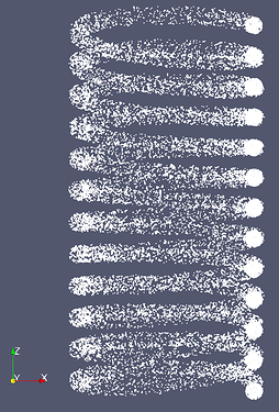

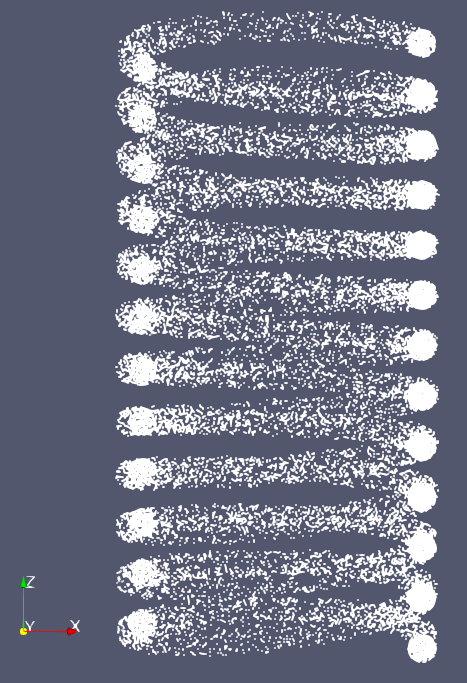

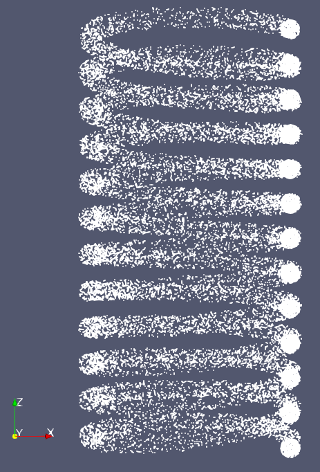

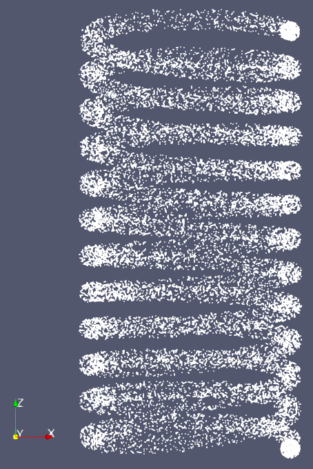

I have designed a 3D helical geometry which has some girth, using NVIDIA Modulus. Defined the inlet and outlet as two very thin cylinders at the top and bottom of the helix, added integral continuity throughout the right side of the helix which consists of several thin cylinders, then finally, the helix has walls (no slip) and an interior space plus some sample discs throughout the geometry. I am trying to simulate water flowing through this geometry from inlet to outlet; top to bottom.
You can see the images above:
Left: Shows the helix walls, interior, inlet (top disc), and outlet (bottom disc).
Middle: Shows the same as left with the added integral continuity discs that occur at the RHS of the helix.
Right: Shows the same as the middle but with the added sample discs at both the LHS and RHS of the helix.

Sample Interior
sample_interior = PointwiseInteriorConstraint(
nodes=nodes,
geometry=sample_discs,
outvar={'continuity': 0, 'momentum_x': 0, 'momentum_y': 0, 'momentum_z': 0},
lambda_weighting={
'continuity': 5 * Symbol('sdf'),
'momentum_x': 2 * Symbol('sdf'),
'momentum_y': 2 * Symbol('sdf'),
'momentum_z': 2 * Symbol('sdf'),
batch_size=cfg.batch_size.interior_sample,
domain.add_constraint(sample_interior, 'sample_discs')
I’ve added some sample discs so I can later process velocity and pressure predictions, given the same constraints as the interior of the helix.
Integral Continuity Discs
def int_cont(n, r, R, pitch, inlet_vel):
integral_disc = Cylinder(center=(r + R, 0, 0), radius=r, height=0.00001).rotate(angle=np.pi/2, axis='x', center=(r + R, 0, 0)).translate((0, 0, n*pitch))
integral_continuity = IntegralBoundaryConstraint(
nodes=nodes,
geometry=integral_disc,
outvar={"normal_dot_vel": inlet_vel},
batch_size=1,
integral_batch_size=cfg.batch_size.integral_continuity,
lambda_weighting={"normal_dot_vel": 1},
# parameterization=z_pos_range,
domain.add_constraint(integral_continuity, "integral_continuity_" + str(n))
print("Made Intergral Continuity Disc " + str(n))
for n in range(1, n_turns):
Made a function which places integral continuity discs throughout one side of the helix and specifies that the ‘normal_dot_vel’ will be equal to the inlet velocity at each disc.

Problem
The velocity and pressure predictions are miles off and I have tried many things to fix this issue like scaling all of the parameters, my nu and rho values used to be 1e-6 and 1000.0 for example, now they have been altered so that they’re less orders of magnitude apart. I did this with the geometric parameters too. Results were different but they’re far away from the validation still.
Does anyone have any clue how to fix this? Help would be massively appreciated because I have officially ran out of ideas. Also please let me know if you’d like additional information about the problem.
