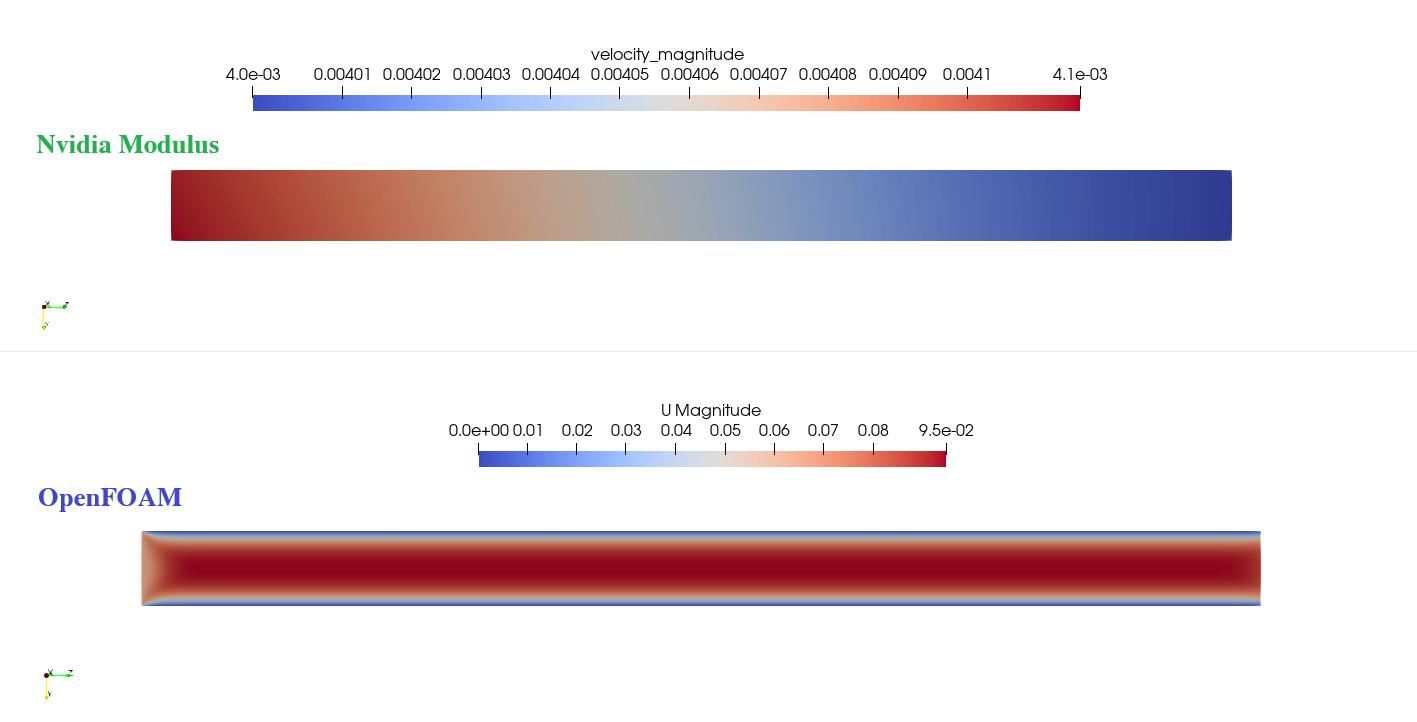

I am working on creating a forward solution model for a simple flow inside a pipe (3D channel) using Navier-Stokes library available in Modulus-Sym. The medium is Glycerin, and the details of the channel and fluid properties are as follows:
Channel and Fluid Details:
  • Channel length = 3 m
  • Channel radius = 0.1 m
  • Fluid density = 1260 kg/m3
  • Fluid kinematic viscosity = 0.00119 m2/s.
  • Inlet velocity = 0.06 m/s
Issues/Queries:
  1. Inlet Constraint Issue: When I checked the inlet constraint in the VTP file, the velocity at the inlet is not correctly applied. Instead of the expected 0.06 m/s, it shows a much lower value of 0.004 m/s.
     What could be causing this discrepancy?
  2. Unrealistic Flow and Pressure Distribution
    After inferencing, the results show unrealistic flow and pressure distributions, even though the training losses are low.
    Below is a figure comparing the results of Modulus and OpenFOAM
Flow velocity is mostly uniform.
Please help me understand why need to consider and missed in trained the model.

I would suggest trying a few techniques to guide Modulus predict the flow behavior effectively:
  1. Use parabolic velocity constraint
  2. Add an integral plane and impose a mass flow constraint (reference).
  3. Start with the default lambda_weighting settings.
  4. Give modulus enough time to train [~100k iterations] and monitor the pressure drop and losses
I’m not an expert—these are based on my trial-and-error experiences.
Please check aneurysm example and this discussion post by @npstrike for more insight.
This is a simplest problem but sometimes very complicated to solve using Modulus-sym.
I hope this helps!
Could you please check the constraint file (no_slip.vtp)? the criteria seems to be clipping the walls of the cylinder.
I recommend using a criteria in the z-direction to properly define the wall region:
criteria = And(Symbol("z") < 1.5, Symbol("z") > -1.5)
