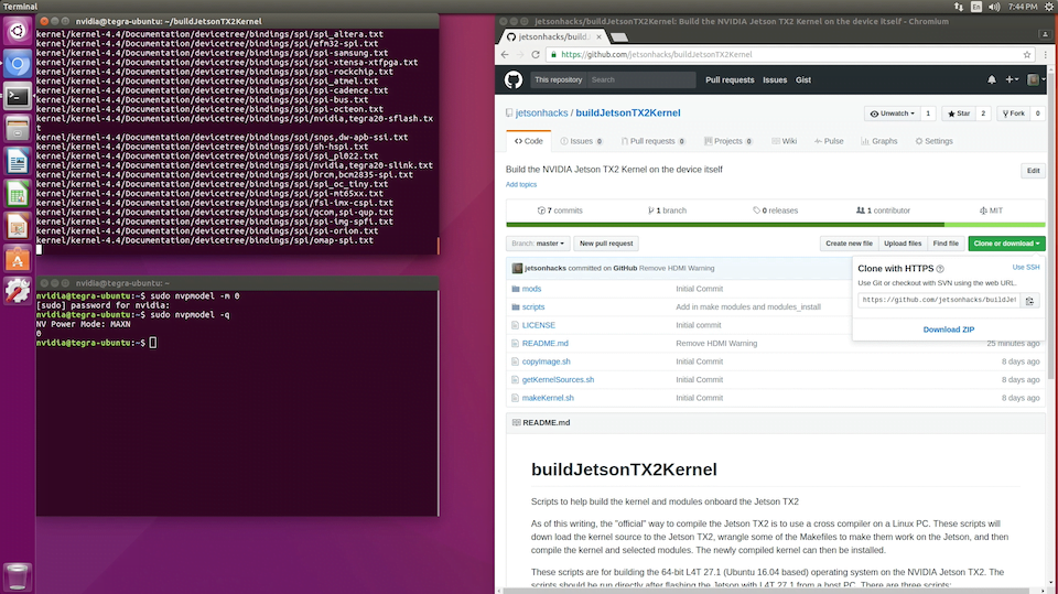

You can get the module as part of a kernel rebuild on the Ubuntu system that you used to flash the TX2 (recommended) or you can get it by building the module on the TX2 itself. I do my builds on the TX2 directly to add modules and initially, I followed this to rebuild the whole kernel w/chosen modules:
You’ll either find the kernel option in the kernel options menu when it comes up or you’ll need to edit the .config file by hand, fixing the USB_SERIAL_GARMIN line where it is commented out to say USB_SERIAL_GARMIN=Y

I finally got it working! Thanks to you all so much. I have learned a lot. Here is how I made it.
To make Jetson identify the Garmin GPS USB as a serial device. The USB_SERIAL_GARMIN module needs to be added (maybe also CH341, I added both). As suggested by ESJS, I followed this link to rebuild the chosen modules on Jetson TX2 itself:
After restarting the Jetson TX2, type “sudo modprobe garmin_gps” in terminal. In this way, Jetson can recognize Garmin GPS.
