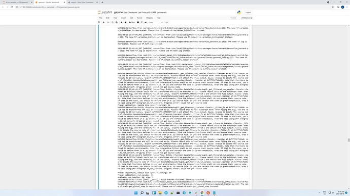

I don’t think I changed anything in the notebook. But I got some warning messages while training.

If I understand correctly, do you mean skip the training and evaluation steps? I just did that and got an error ‘Please provide a valid gazenet file path for evaluation.’ Or is there anything need to be changed in the spec yaml file? Thank you.
File “/opt/tlt/.cache/dazel/_dazel_tlt/2b81a5aac84a1d3b7a324f2a7a6f400b/execroot/ai_infra/bazel-out/k8-fastbuild/bin/magnet/packages/driveix/build_wheel.runfiles/ai_infra/driveix/mitgazenet/scripts/inference.py”, line 121, in
File “/opt/tlt/.cache/dazel/_dazel_tlt/2b81a5aac84a1d3b7a324f2a7a6f400b/execroot/ai_infra/bazel-out/k8-fastbuild/bin/magnet/packages/driveix/build_wheel.runfiles/ai_infra/driveix/mitgazenet/scripts/inference.py”, line 117, in main
File “/opt/tlt/.cache/dazel/_dazel_tlt/2b81a5aac84a1d3b7a324f2a7a6f400b/execroot/ai_infra/bazel-out/k8-fastbuild/bin/magnet/packages/driveix/build_wheel.runfiles/ai_infra/driveix/mitgazenet/inferencer/gazenet_inferencer.py”, line 97, in build_model
ValueError: Please provide a valid gazenet file path for evaluation.

Yes, skip the training and evaluation steps. Please use the pretrained trainable tlt model and directly run inference with it.
I try on my side, the inference result looks ok.
Please refer to below command in notebook.
