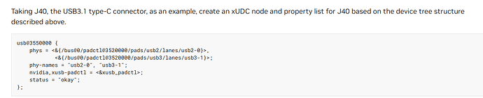

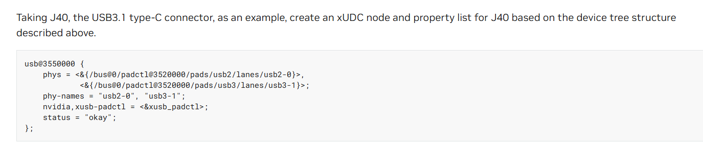

As the default BSP linux package from NVidia website will be loaded and flshed on the orion NX developer kit SOM module, which also supports recovery mode and flashing, I expected some device tree changes/updates already in this file, but I cannot see any device tree changes in this .dtsi file for configuring usb2-port 0 for OTG mode.
1)Could you explain this discrepancy?

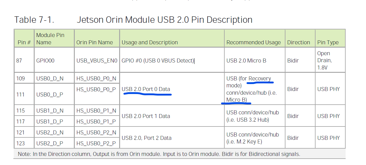

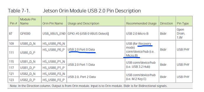

  1. Also in the below snippet from product design guide, it recommends we should configure it as Micro B type of USB.
    But our hardware guy says Type A also fine. please confirm which is the correct one.
No, that is not correct. Have you ever seen there is someone use “type A” usb port to run as a usb device in your life? I guess not. All of them are all usb host mode…
Type A does not support OTG by its nature. Lacking of vbus_det pin and id pin.
hardware/nvidia/t23x/nv-public/tegra234-p3768-0000.dtsi
code snippet
79 			ports {
80 				/* recovery port */
81 				usb2-0 {
82 					mode = "otg";
83 					vbus-supply = <&vdd_5v0_sys>;
84 					status = "okay";
85 					usb-role-switch;
86 				};
87
hardware/nvidia/t23x/nv-public/nv-platform/tegra234-p3768-0000+p3767-xxxx-nv-common.dtsi
 		padctl@3520000 {
182 			ports {
183 				usb2-0 {
184 					port {
185 						typec_p0: endpoint {
186 							remote-endpoint = <&fusb_p0>;
187 						};
188 					};
189 				};
190 			};
191 		};

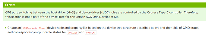

Instead I see the below ctype node in the documentation link. Can you explain this variation with respect to type B and Type C customization while updating device tree…
typec@8 {

You could read document first… That is why it exists. It has the explanation of how it works…
I have read 2 times already. What ever questions I am asking is after reading there only. But some things are not clear. Only those things I am asking here for clarity.
I feel, it not fully up to the mark.
It says
but does not clearly tell whether
1)It is applicable for customized board for orion NX
2) If it not required or applicable for device tree, then why they have documented here.
  1. As I already told, this whole document is applicable for any kind of Orin platforms… It is talking about general rules for usb device tree…
  2. You misunderstood it… This document note is talking about “this section is not part of device tree of Orin AGX devkit because Orin AGX devkit does not use this solution.” Orin AGX devkit is using Cypress Type C controller as solution…
    If you want to make a micro USB port on your board, then you need to refer to this section …

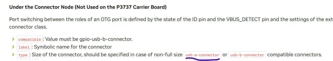

I see a mentioning of usb-a-connector here, I understand it is talking about type.
for usb-b-connector the type=“micro”.
in case of usb-a-connector as mentioned above what should be the type value?
You had told usb-a-connector wont be applicable here earlier. Its mentioned here as just a type. please clarify.
Shouldn’t we be adding the below node as well, apart from the above two mentioned here . for USB2.0 Type C connector. kindly confirm.
You can just read the code of this user.
His device tree is correct in accordance with their schematic…
