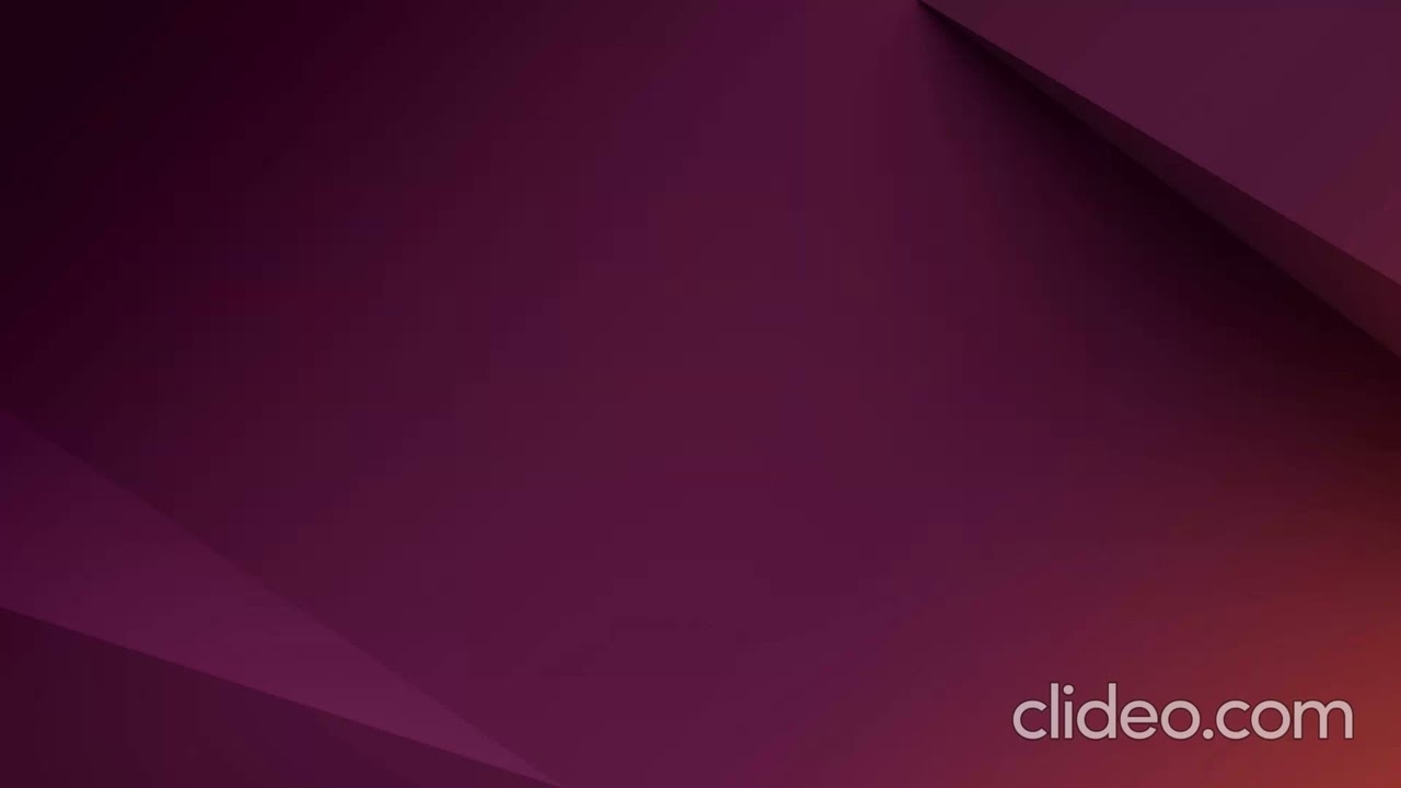

Using Ubuntu24.04 on a laptop, I experience glitchy artifacts/blocks/checkerboard pattern and what looks like some remarkable diagonal line.
This glitchy behaviour only appears in the following situation:
  • Using Wayland (on X11 there is no glitching, so the HDMI cable/monitor is also not the issue)
  • On the physical display (screen record on Wayland shows no glitching)
  • On the external display connected to the HDMI port controlled by nvidia chip and drivers (buffer is located in nvidia chip according to nvidia-smi, around 50 MiB).
  • There is no issue on other displays, which are managed by the intel iGPU (built-in screen and usb->displayport devices)
Video of the problem (enable subtitles/annotations!):

Note that the issue already exist for quite a while, also in previous driver/mutter versions.

Also happens on driver 575.64.03
I have the exact same glitches on 580.82.07 (GTX 1650 Max-Q). It has been like this for a couple of years and still hasn’t been fixed.
Why does no one from Nvidia answer?
