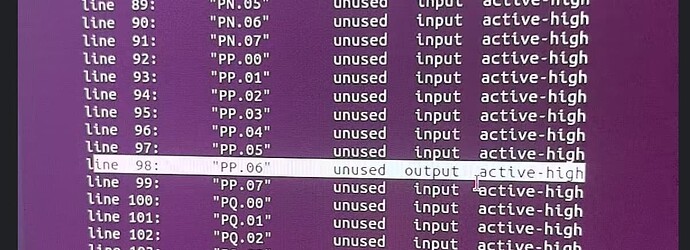

Gpioset cannot change the GPIO state
jetson orin nx 8GB custom board
Jetson36.4.4
The tested GPIO is GPIO2,GPIO3_PP.06 OUTPUT/Drive 1
Test command:
sudo gpioset gpiochip0 98=0
It does not work.
The phenomenon is that it first turns to a low level and then turns to a high level after a short period of time
After reviewing similar posts, I realized that this may be related to Drive 1, as I saw the engineer’s suggestion for Drive 0.
The problem is that I need to configure GPIO before entering the system to properly initialize the display (GPO2 is the pin that controls display switching), and I want it to output a high level during the bootloader phase like Pinmux. What should I do?

Hi 1091192337,
Have you configured the pinmux for PP.06 before use?
Both should be fine. pinmux/gpio dtsi are loaded in early boot(MB1) so that Drive 0 or 1 is configured for the default state.
Please try using the following command instead.
# gpioset --mode=wait `gpiofind "PP.06"`=0
