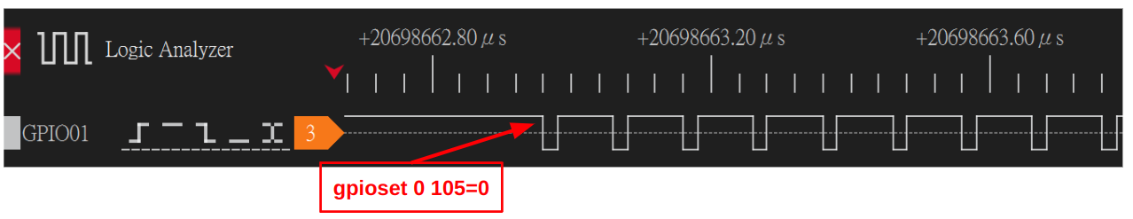

Without the buzzer’s VCC connected, the GPIO toggles high and low as expected. However, when the buzzer’s VCC (3.3V) is connected, setting the GPIO output low causes a brief low pulse but the output quickly returns to high. Using gpioset --mode=wait 0 105=1 (GPIO01) or Python RPi.GPIO GPIO.output(29, GPIO.LOW)keeps the buzzer active, but oscilloscope shows rapid voltage fluctuations.

However, our second issue still remains: the GPIO output does not stay low when connected to a buzzer with VCC(3.3V) connected. The GPIO is expected to stay high by default and remain low after we set it low. However, it fluctuates between high and low. Could this be caused by weak drive strength or misconfiguration? (We configured the pinmux with sudo busybox devmem 0x02430068 w 0x004)
