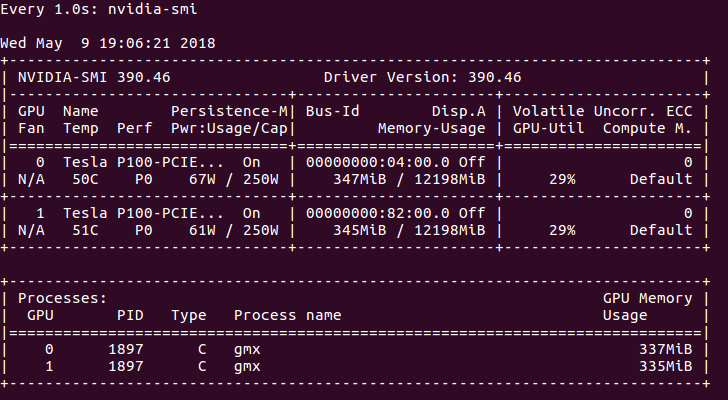

We have a Dell PowerEdge R730 Server with Ubuntu 16.04. The server had 2X P100 cards. Cuda
version 9.1 was installed.
I am running a Molecular Dynamics Simulation with Gromacs package.
I have observed that the P100 cards are showing 20-30% utility percentage only.
Why the cards are not able to provide max utility performance? How I can optimize it further?
Please find in the attachment, the output of nvidia-smi:
Thank You
Not enough cpu power to feed two P100? i.e. how high is cpu utilization during computation?
Thank you for your response.
The CPU utilization is always 99% to 100%.
If that’s on all cores, the application is cpu bound so only more cpu cores will help.
