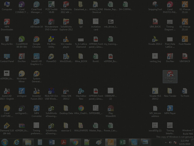

Gray overlay over the original video frame
We have designed a video card in which we are using video decoder (ADV7604) and nVidia Jetson TX-2. When we are running following pipeline, getting following error:

Please help us to understand the problem and resolve it.

Dear DaneLLL,
Thank you for your suggestion.
Problem get resolved by decreasing the offset and increasing the gain of the video decoder.
