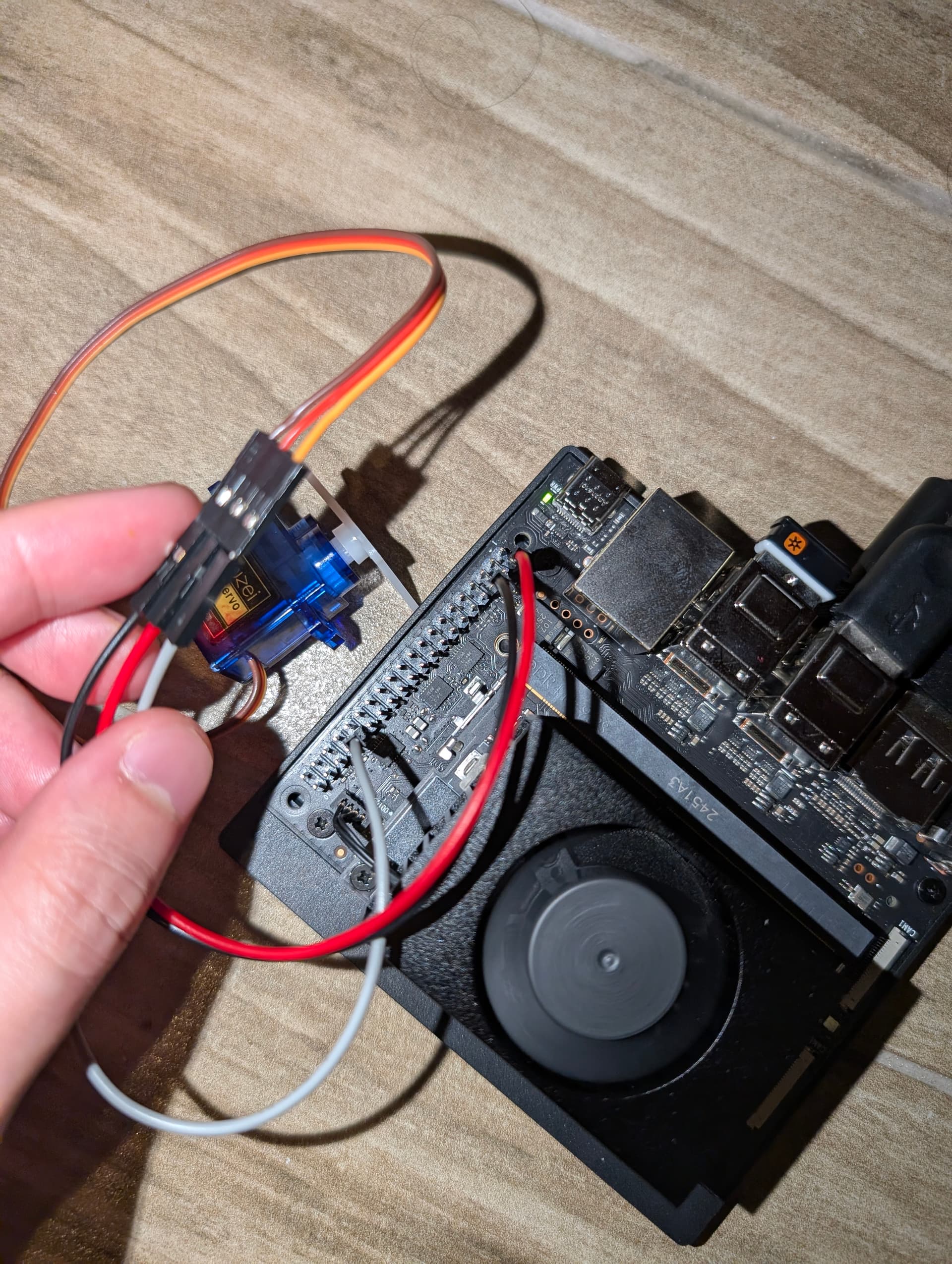

Having trouble with GPIO pins
I have just gotten my jetson orin nano and can’t seem to get some simple python tester code working on it before i wire it to my motor drivers. Am I doing something wrong here? the 5v seems to be working, as well as the servo, as it twitches when I attach and detach the 5v wire. The code runs with no issues. Here is my code and my setup. I would be grateful if you could help. Thanks.

  • Red wire → Pin 2 (5V)
  • Brown wire → Pin 6 (GND) [or any other GND: 14, 20, 30, 34]
  • Orange wire-> Pin 32 (GPIO07/PWM)

Hi ohme33,
It seems you are using Orin Nano devkit.
Have you configured the pinmux for PIN32 of 40-pins header before use?
Or have you tried using gpiod to control this pin?
