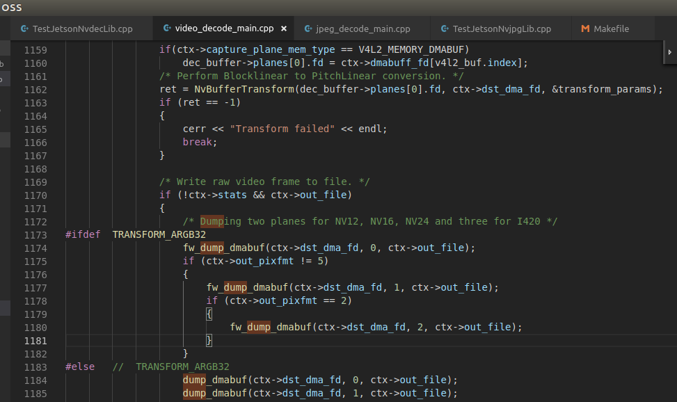

Before NvBufferTransform, the output_pixformat of the decoded buffer was forced into ARGB to create a buffer with RGB values.
Is it possible to create an RGB buffer like this and render it using OpenGL? (without using NvEglRenderer)
Thank you.
① Set the output pixel format to ARGB32
② In ARGB32 format, dump_dmabuf is called only once.
③ In the ARGB32 format, write to the file as follows.
The file written in that way has RGB values as follows.
Is it okay to do this?
Thank you.

Are you sure that the above psrc_data contains data that has been successfully decoded and converted to rgb?
If we allow our customers to use RGB data decoded in Nano, can we provide it through the above process?
