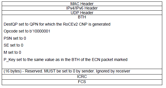

I tried to capture all the packets issued and received during the test. But I could not find the packets with ECN marked. Couldn’t these control packets be captured by the administrator?
However, I could find the CNP packets like this:
Same format with the RoCEv2 congestion management standard:
But this method for getting the statistics of DCQCN was too expensive. Could someone give some pieces of advice?

CNP packet format:
https://enterprise-support.nvidia.com/s/article/rocev2-cnp-packet-format-example
