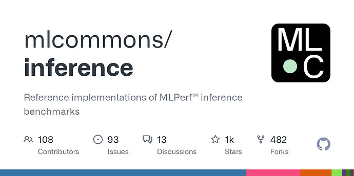

Hi
It is tested with the production board but the devkit should also generate close results.
Below is the reference app and guidance for your reference:

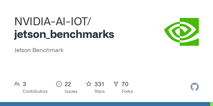

I have tested jetson benchmark and found the following score for my development jetson nano, but I am not sure if it is reasonable.
The official website did not find the relevant reference score of jetson nano, could you please provide it?
