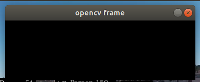

Hello I have used this code to convert the buffer to cv::Mat but when I show the image with cv::imshow it does not show the image it show a black screen and the window that opencv imshow creates its’s size is smaller than the image’s dimensions. g_imagesBatch is a global std::vector<cv::Mat> and all of this is happening inside appsink callback.

Thanks for your reply I changed it and it still don’t work the frame is black and small.
In my pipeline I set the nvvideoconverter memory type 3 I tried all the types but nothing works.
g_object_set(G_OBJECT(nvvidconv), "nvbuf-memory-type", 3, NULL);
Screenshot from 2021-05-20 16-47-01

I guess here is unsafe since you had unMap the surface but you still can access the in_mat.
