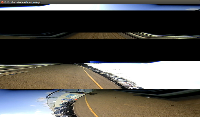

Hi kay,
Instead of this git, I’m testing DS 4.0 sample program for this issue.
/opt/nvidia/deepstream/deepstream-4.0/sources/apps/sample_apps/deepstream-dewarper-test
However, I cannot find out proper parameters even DS plugin manuals at all.
Could you recommend some sample parameters for 1 x fish-eye camera(180 degree) input to make rectified video?
Thanks,
The input source of the sample is a video file. Have you tried to run the default application?
$ ./deepstream-dewarper-app file:///home/nvidia/deepstream_sdk_v4.0_jetson/samples/streams/sample_cam6.mp4 6
scr_ds_clip.png is as expectation. It demonstrates four surfaces in config_dewarper.txt
We are checking to have more information on parameter tuning.
Please refer to section 2.8.3 in
Hi Dane,
It’s not easy to modify configuration files.
Since, I think, my video clip is 180 degree but example uses 360 degree,
output display is crashed.
Could you a suggest template configuration file for 180 degree fish-eye video clip?
FYI, I can share a clip.
Thanks,
The video sample is in 1472x1384. Please check if you can adapt your source to this resolution. See if the same resolution still triggers the crash.
