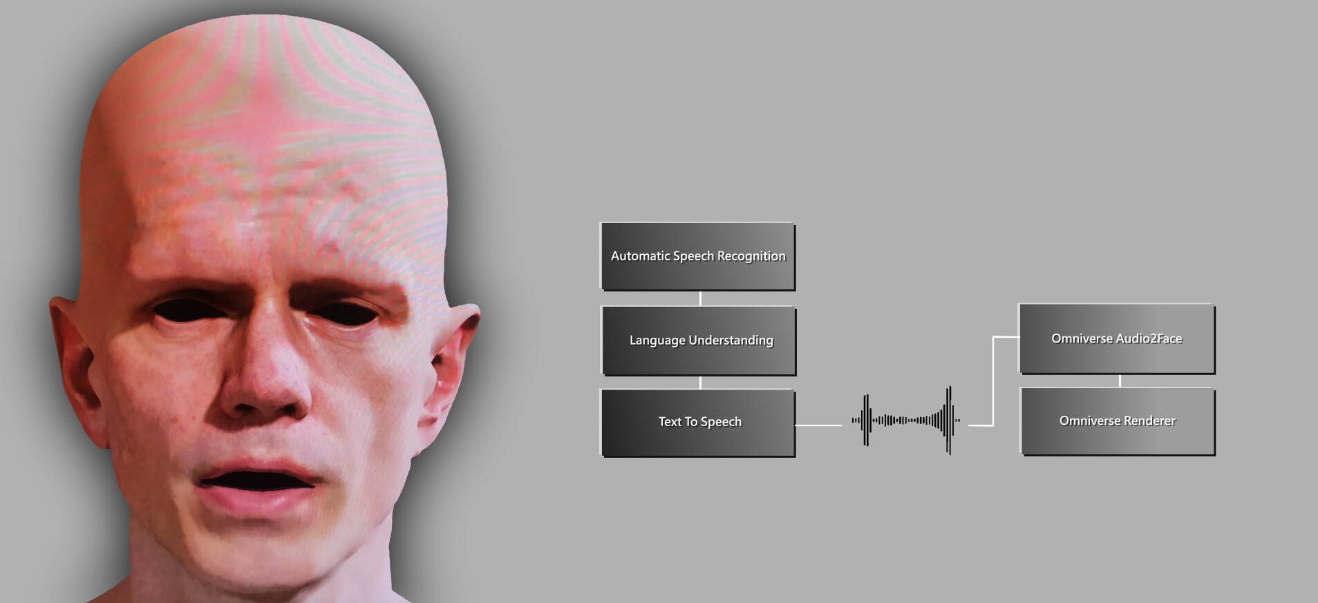

Just to be clear of what I need help with, and its simple to me. From the picture above, see the digital human, I want to build/design, the same. It seems that that picture was developed from a regular photo and technology added to use it.
What technology? Do I need to learn all the technologies below?

OVA is about powering AI driven avatar. Creating or bringing in your own 3D model is current required and we work closely with many partners to help provide that.
Epic, Reallusion, Daz …etc
We provide AI based animation, Intelligence piece through Riva and NLP. We have not shipped the full solution yet and is still in development. Stay tuned for more updated announcements regarding this very soon.
Currently we do have customers if they are comfortable to take some of these technologies are use them, they can do it now. Running Riva ASR, TTS, Dialog Manager to then drive Audio2Face for an interactive experience. The process is bit more involving but doable.
For an easier solution, you would have to stay tuned for it, we will have some news on this soon.

Just additional information, if you are interested to use A2F quickly to build an interactive chatbot, here is a tutorial one of our user did. Check it out. We do plan to make the process easier, stay tuned for that.
