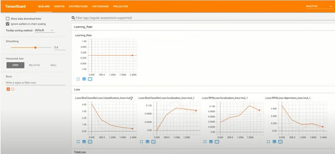

Also i want to ask a question, if it is possilble to get the information of the loss function during training, or directly get the line graph like this:
You can ignore the INT64/INT32 warning, that is fine. Unfortunately I’m unable to directly help integrate the model with JetBot, although you are probably correct in that it has different pre/post-processing - hence my suggestion to run it with jetson.inference.detectNet() and then deliver the resulting bounding boxes to JetBot.
PyTorch supports tensorboard, you would need to add it to train_ssd.py though:
