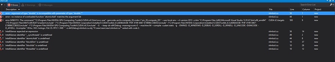

Thanks alot guys for your suggestions. I have sorted out the problems. But only following issues I could not solve. It says “cblas.h”, “matrix_funcs.h” and “mex.h” source files cannot be opened. I have searched in the Program Files\MATLAB\R2014a\extern\include directory. mex.h file is available but I cant get it why it cannot be opned. Other two files are not available in the directory. Even I have not used other two header files in my code as well but still dont know why it is asking for “cblas.h” and “matrix_funcs.h”
any good suggestion will really be appreciated. Thanks…
[img]C:\Users\Admin\Desktop\Untitled.jpg[img]
