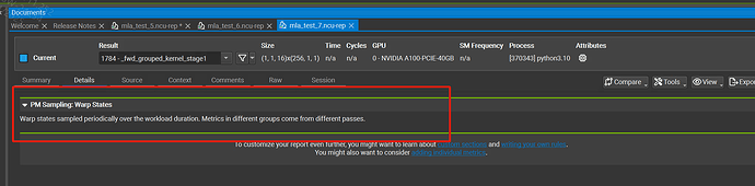

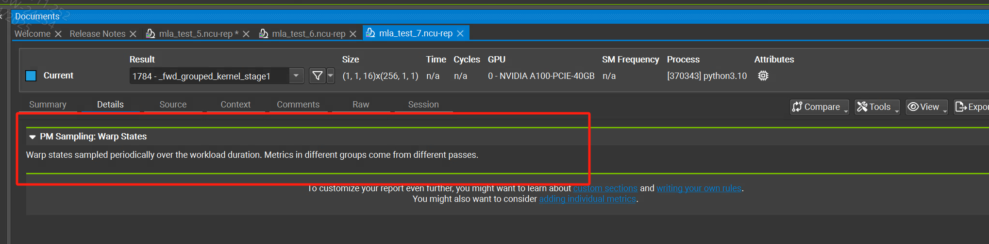

Hi, there is a problem that nsight-computing didn’t collect PmSamping_WarpStats metrics.
Does A100-PCIE-40GB support collecting PmSamping_WarpStats metrics? or did I miss something? I am looking forward to reply, thx!
My CLI Command: ncu --export XXX --section PmSampling_WarpStates python XXX.py

Hi, @yuxinliu_oliver
PmSampling_WarpStats section requires MinArch: CC_86.
A100 is CC_80.
You can find the restriction in sections/PmSampling_WarpStates.section
