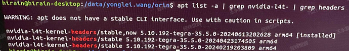

I’m using jetPack5.1.3, L4T 35.5, and I don’t see the nvidia-l4t-kernel-headers package, and I don’t see the -H parameter in flash.sh
Please run the commands on AGX Orin:
$ sudo apt update
$ apt list -a | grep nvidia-l4t-kernel-headers
You should be able to see the package.
