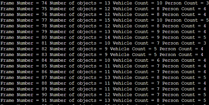

How to look at the tensor output in deepstream-infer-tensor-meta-test
Here we can look at the count on the terminal. But what if one wants to see the tensor output of a vehicle if a vehicle is detected or tensor output of a person if a person is detected?
Hey,
I need to use the tensor output for further analysis. So please suggest me how can I achieve it.
