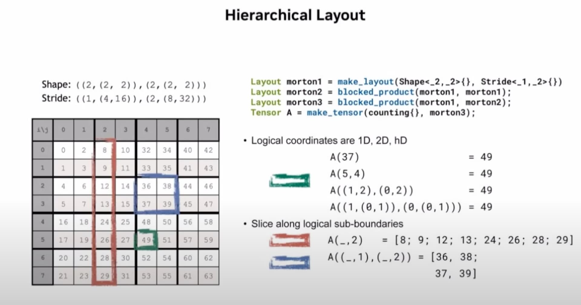

I am trying to extend this to hierarchical mapping for the matrix mentioned in below. I am referring to this from the video,trying to understand how this works for the value 49
1D => A[37] = 49
2D => Matrix Shape( 8,8 )=> Stride (1,8) . Hence A(5,4) => 5 + 4*8 = 37 => A[37]
h-D => ((1,2),(0,2)) , I could not trace this back to linear index 37. Below is my understanding . Could you help in how to map this to linear index , also how to visualize (1,2) from the row part and column part (0,2)
matrix size (8,8) is divided into 2 Groups on Rows, 2 Groups on Columns which results in 4 matrices each of (4,4) size with indexes. 1 & 0 from ((1,2),(0,2)) corresponds to (1,0) outer tile mentioned below, which does not have 49 . Hence I could not find a way to map this to linear index
But what I tried to do is to map ((1,2),(0,2)) => (5,4) to do this I tried to flatten it using the strides , not sure if this is correct approach
(2,2,2) the first two indices of the tuple (2,2), applying the same formula to unflatten
5%2 = 1 & 5/2 = 2 => (1,2)
4%2 = 0 & 4/2 = 2 => (0,2)

Inner (Thread Blocks):-
Each Outer Tile is further broken into 2* 2 Matrices resulting 4 2*2 matrices
Threads
Each inner Tile is further broken into 2 groups in rows 2 Groups in columns resulting in 4 (1*1) matrices
