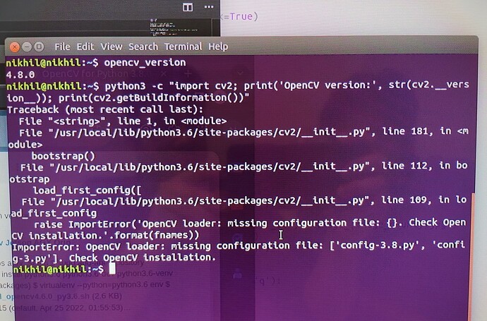

How to resolve the missing configuration file error below on the Jetson Nano
How do I resolve the missing configuration file error below:
(I’m using Jetpack 4.6.1, the default version of Python is 3.6.9 and I have installed Python 3.8.0 on the Jetson Nano.)
The command opencv_version returns 4.8.0 and python3 returns 3.8.0.
But python3 -c "import cv2; print('OpenCV version:', str(cv2.__version__)); results in the error below:
 nikhil@nikhil:~$ opencv_version
4.8.0
nikhil@nikhil:~$ python3 -c "import cv2; print('OpenCV version:', str(cv2.__version__)); print(cv2.getBuildInformation())"
  File "<string>", line 1, in <module>
  File "/usr/local/lib/python3.6/site-packages/cv2/__init__.py", line 181, in <module>
    bootstrap()
  File "/usr/local/lib/python3.6/site-packages/cv2/__init__.py", line 112, in bootstrap
    load_first_config([
  File "/usr/local/lib/python3.6/site-packages/cv2/__init__.py", line 109, in load_first_config
    raise ImportError('OpenCV loader: missing configuration file: {}. Check OpenCV installation.'.format(fnames))
ImportError: OpenCV loader: missing configuration file: ['config-3.8.py', 'config-3.py']. Check OpenCV installation.
ERR (1)~2
Please help me resolve this.
When you import the package with Python3.8, it looks for the package that under the Python3.6 and leads to the error.
Could you try the below command to see if it works?
echo 'export LD_LIBRARY_PATH=/usr/local/lib:$LD_LIBRARY_PATH' >> ~/.bashrc
echo 'export PYTHONPATH=/usr/local/lib/python3.8/site-packages/:$PYTHONPATH' >> ~/.bashrc
source ~/.bashrc

The error has not resolved, pls help. @AastaLLL
Appended the two lines below in the bashrc file:
Have you built OpenCV with Python3.8?
You can follow the below instructions but update to your python version:
Yes.
I’m required to install Python 3.8 or later versions, (the step shared above seems to be for Python 3.6) just so that I’m able to install the Ultralytics package.
Please share the steps to install Python 3.8 and OpenCV with Cuda support for the Jetson Nano.

Ever since I tried installing Ultralytics, I’ve been getting the error above. How go I resolve this, kindly help.
@AastaLLL Kindly revert
You will need to build OpenCV with Python 3.8 as well.
The default version is built with Python 3.6.
Have you built it from the source with Python 3.8?
Yes, I’ve built OpenCV from source for Python 3.8
How do I check if OpenCV is built with CUDA support? @AastaLLL
How do i enable cuda support for OpenCV? @AastaLLL
You can find it in the building info:
