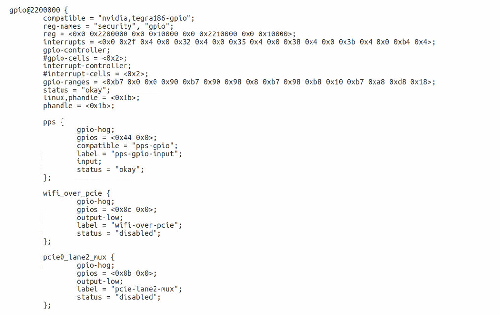

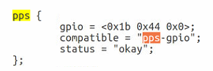

you may also disassembler the dtb file into text file for examination.
for example, $ dtc -I dtb -O dts -o output.txt tegra186-quill-p3310-1000-c03-00-base.dtb
thanks
yep, pps statement appers in the ouutput.txt.
However, I still cannot find the gpio388 port in cat / sys / kernel / debug / gpio.
What am I wrong?
