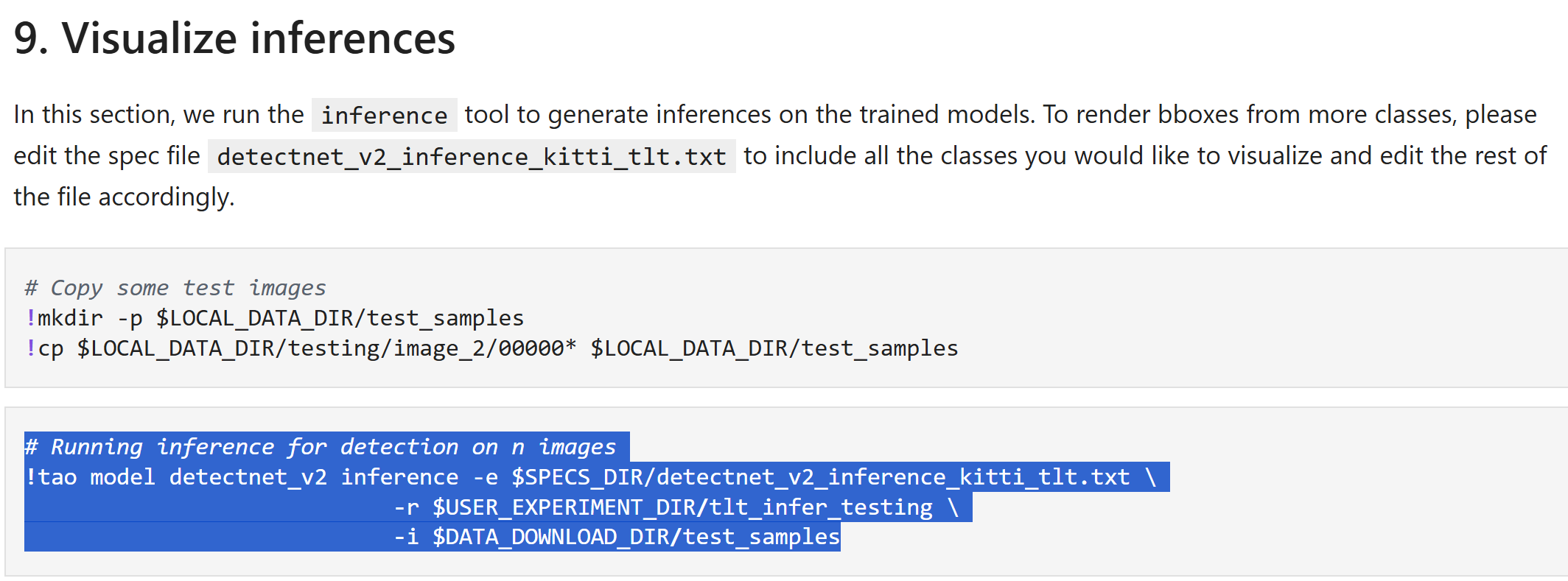

Im using the model out of box can you provide me model, config and working command to use please?
If you use this config file, the inference is running against the xxx.hdf5 file(It is generated during training process).
You can not replace it with xxx.etlt file( .etlt file is actually an encrypted uff file for peoplenet).
So, suggest you download peoplenet from https://catalog.ngc.nvidia.com/orgs/nvidia/teams/tao/models/peoplenet/files?version=trainable_unencrypted_v2.6. Then use the https://raw.githubusercontent.com/NVIDIA/tao_tutorials/refs/heads/main/notebooks/tao_launcher_starter_kit/detectnet_v2/specs/detectnet_v2_inference_kitti_tlt.txt to run.
The command is mentioned in tao_tutorials/notebooks/tao_launcher_starter_kit/detectnet_v2/detectnet_v2.ipynb at main · NVIDIA/tao_tutorials · GitHub.
# Running inference for detection on n images
!tao model detectnet_v2 inference -e $SPECS_DIR/detectnet_v2_inference_kitti_tlt.txt \
                            -r $USER_EXPERIMENT_DIR/tlt_infer_testing \
                            -i $DATA_DOWNLOAD_DIR/test_samples
