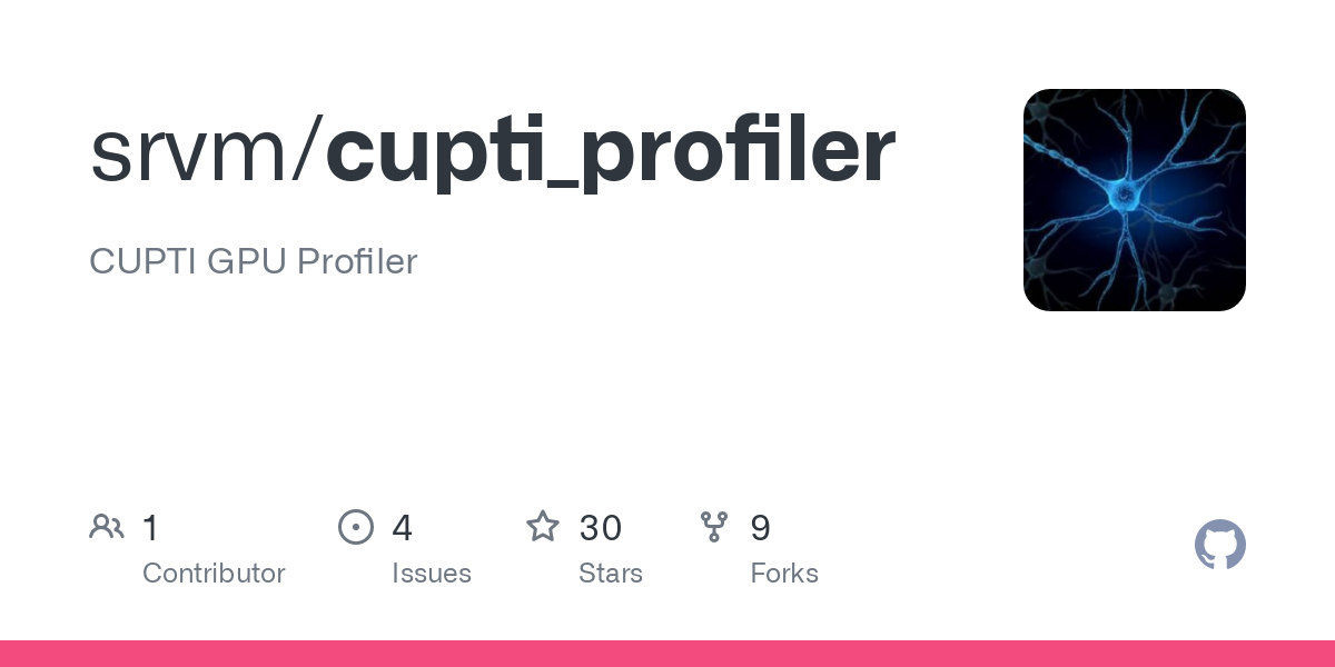

We have updated the CUPTI sample code on github : https://github.com/srvm/cupti_profiler.
It includes fixes for the issues reported on this post.
It also includes query and collection of all the supported metrics.
To profile specific metric you can comment the following line in examples/demo.cu:
#define PROFILE_ALL_EVENTS_METRICS 1
Thanks for your feedback.
