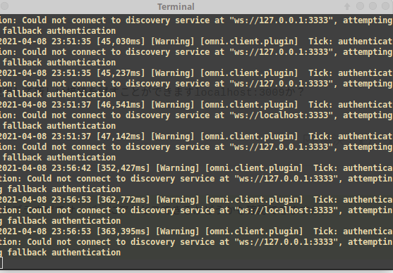

When I try to sign in to the Nucleus server from Isaac Sim, I get the following error and cannot sign in:
2021-04-08 05:21:06 [68,704ms] [Warning] [omni.client.plugin] Tick: authentication: Could not connect to discovery service at “ws://localhost:3333”, attempting fallback authentication
Screenshot from 2021-04-08 14-20-55
I changed the default nuclear server settings in _build / linux-x86_64 / release / experience / isaac-sim.json, but it didn’t make sense.
Can anyone please tell me why I can’t connect to the Nucleus server?

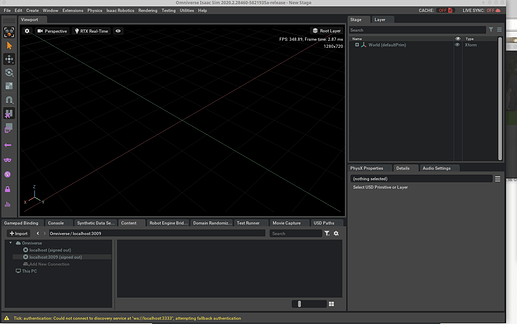

Could you try the new connection using the workstation IP XX.XX.XX.XX:3009 instead of using localhost:3009?

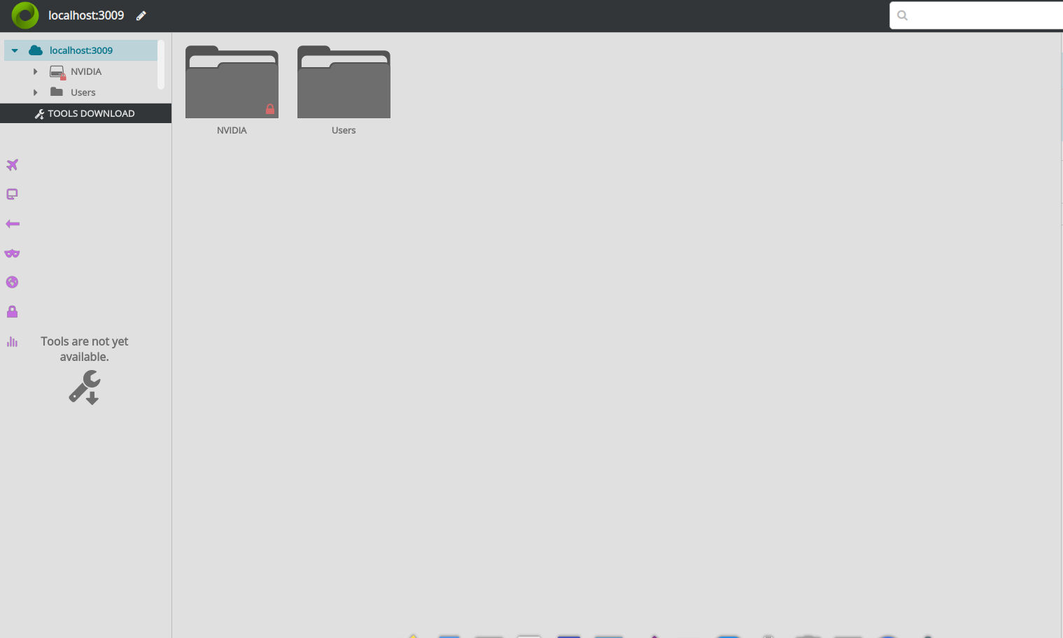

Try 127.0.0.1:3009 too. Can you also check if you can access the server on the browser at http://localhost:8080/login.
The warning is fine. It can we ignored.
Thank you for your reply.
I tried both [127.0.0.1:3009] and [localhost: 3009], but the problem was not resolved.
I can access the omniverse browser from http: // localhost: 8080 / login.

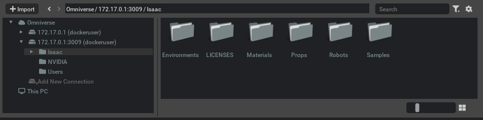

I have the same problem using localhost and 127.0.0.1 (red). However, I am running all using docker containers. That is why only the real workstation IP (where I have all the containers) works (green)
You can use the command ip a to know the IP of the workstation
I succeeded in that!
Now I can use the Nucleus server.
