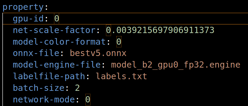

I successfully ran the example above.There is one more parameter batch-size in dstest3_pgie_config.yml that needs to be changed to 4.

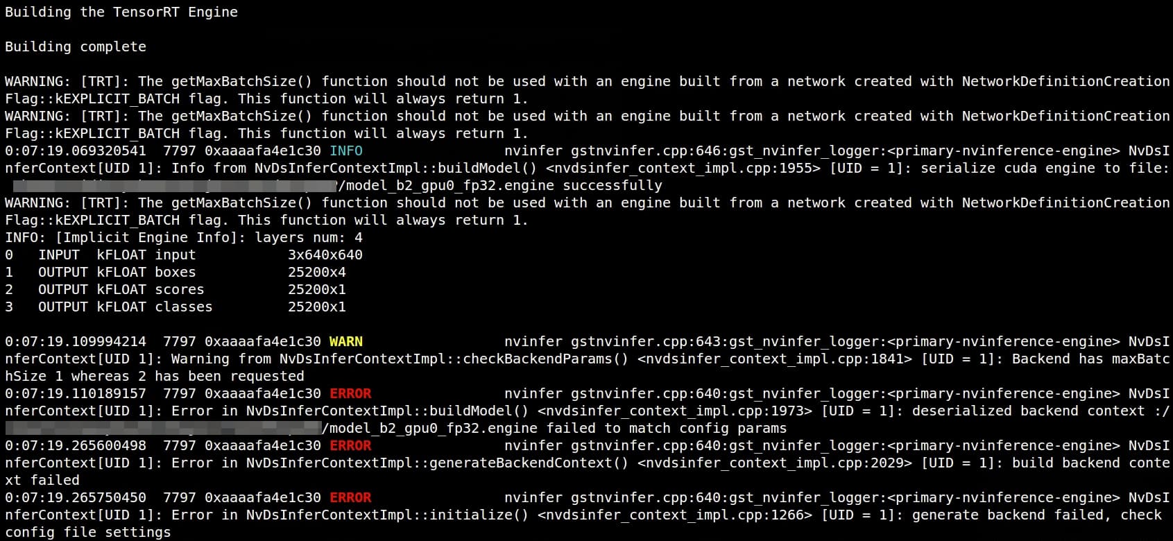

When I used a self-trained YOLO model to perform similar operations, I encountered the following errors.
I used nvdsinfer_custom_impl_Yolo to generate model engine file.What has gone wrong?
Did you copy the engine file from somewhere else?
This error indicates that the batch size parameter of the generated engine file is incorrect.
Delete the engine file and run it again
No.I just modified the parameters in the dstest3_pigie_config.yml file like this.
And the engine is automatically generated, as shown in the first two lines of the previous image.
Which version of yolo is your model based on? There should be some problems with the parameters in your configuration file.
You can refer to the yolo configuration items in this project
GitHub - marcoslucianops/DeepStream-Yolo: NVIDIA DeepStream SDK 6.3 / 6.2 / 6.1.1 / 6.1 / 6.0.1 / 6.0 / 5.1 implementation for YOLO models
Ultralytics-YOLOv5.Can I use this model to run the test3 project?
Yes, of course, follow the steps of the link I posted above and you can see the results.
It is no different from test3
