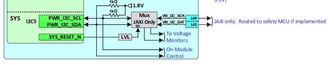

Hello again.
I did, before reaching out to you for assistance.
However, I could share my findings. But I still need some guidance.
(DG-09840-001_v2.6)
First off - the bus is exposed on L44/L45 (on JAXi). We are not using those pins for anything on our carrier board/not routed from the contact.
(DG-09840-001_v2.6)
The “Mux JAXi Only” routes to “Voltage Monitors”. “On-Module Control” also seems to be on the bus.

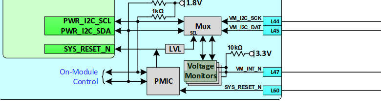

(DG-09840-001_v2.6)
“Voltage Monitor” seems to be exposed on L47 - which is not used for anything on the carrier board.
There must be a list of the addresses exposed on the bus somewhere - but I cannot find it in the documents.
So, if you could help with supplying one (or the information in any other way), I would appreciate it.
Hi, 0x50 is address of a phase buck controller used on module. The address list of I2C5 is not public as it is on-module only.

There is a level shift on the I2C bus to convert 1.8V to 5V for the VDD_GPU buck. If it has problem, the I2C device detection of the buck will fail. According to your tests and descripiton, the level shift might fail and so cause the random detection. But it won’t cause the VDD_GPU output fail since the buck uses default settings, and so AGX is healthy. You can run RMA for the modules if you have concerns on this.
