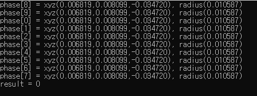

Hello, i have a question about my cuda programming.
For making accelerating the programming, I made a simple code to cuda programming.
However, i got a problem such as no numbers return except zero. I looked up several times but using a host with my source code worked very well. So i tried to find out the programming in CUDA source but i cannot find a problem.
For making a AoS(array on structure) in CUDA, I made a followin codes.

This is my main function.
please help me to find a problem.
Thank you!
ps. I will attach the result images.
please provide a complete code, not bits and pieces.
what are maxNum and THREADS ?
Your output variable is count:
__global__ void function(points *devin, int *count, int size)
Your kernel code doesn’t write to count anywhere
so the result printout is always going to be zero:
int counts=0, *dev_count;
	cudaError(cudaMemcpy(dev_count, &counts, sizeof(int), cudaMemcpyHostToDevice));
        function<<<blocks, threads>>>(dev_alpha, dev_count, limit);
	cudaError(cudaMemcpy(&counts, dev_count, sizeof(int), cudaMemcpyDeviceToHost));
	printf("result = %d\n", counts);
If you add this line at the end of your kernel:
if ((xa != 0 && ya != 0 && za != 0) && za < dmin || za > dmax || radius >= dradius) {
                        start++;
                atomicAdd(count, start); // add this line
You may get some non-zero result.

You’ve changed the code. Anyway my previous answer shows what the problem is, although you’ve changed variable names. (change count in my answer to dev_count to match your new code)
Ops, I made a different one. But thank you for giving me advice!
I solved problem with your help!
