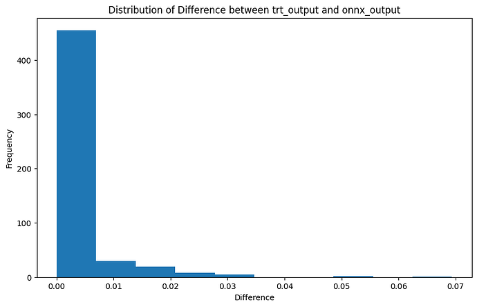

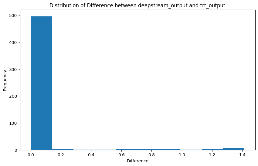

Its a three class classification model and i computed the Euclidean distance between the probability score and the distribution is as follows.
what I am trying to say is that the same engine file running inside and outside deepstream is giving me different results.
