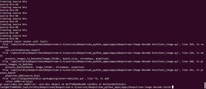

I am trying to run a DeepStream pipeline on multiple images from a folder using the provided pipeline, but I am encountering a CUDA error. When attempting to perform batch-wise inference on a folder containing images, I receive a gi.overrides.Gst.AddError error.
Can anyone help me set up inference on a dynamically updating folder with images using DeepStream?

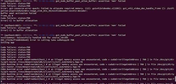

I tried using multifilesrc still getting cuda failure error.
Could you refer to the dGPU model Platform and OS Compatibility and check if the version of the softwares you installed match those in the table?

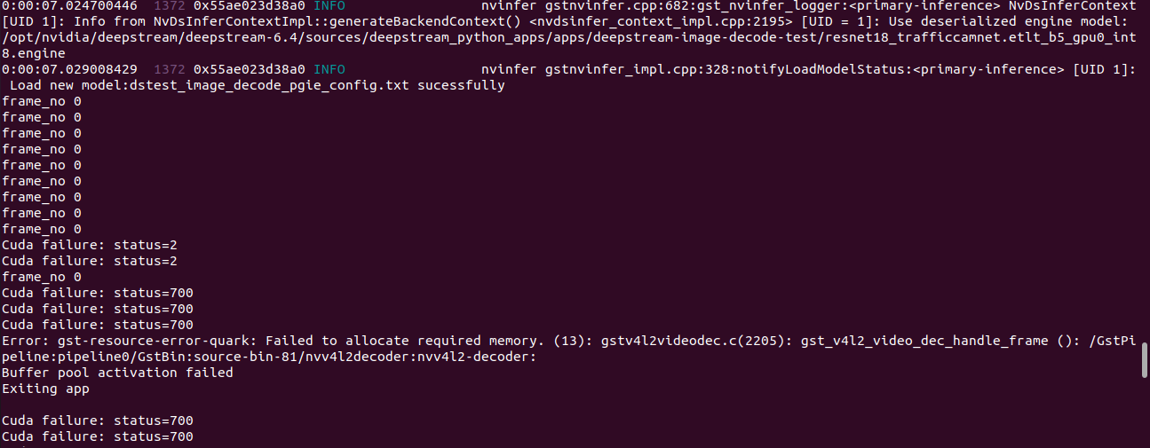

When you are using multifilesrc, you don’t need to create multiple ones. You need to modify your demo code to the pipeline like multifilesrc->jpegparser->decoder->nvstreammux->nvinfer.... Please refer in detail to the link I attached. If you create too many source_bins in your code, it will run out of the decoder resources.
Thank you. I have changed the pipeline to multifilesrc -> jpegparser -> decoder -> nvstreammux -> nvinfer.... However, after processing 4 frames, it stops, even though my folder contains around 1000 images. I tried using the stop-index property in multifilesrc, but it didn’t resolve the issue.
deepstream_image.txt (9.9 KB)
Are your images named as consecutive numbers?
No, I have changed the image names to consecutive numbers and ran the pipeline; it worked. Thank you.
Is there any way to run this pipeline on images with non-consecutive numbers?
No. This is limited by the multifilesrc plugin.
