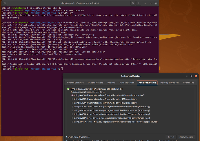

I reinstalled from scratch. I think the problem in the installation part has been solved. But now there is another problem:
Can you run below successfully?
$ tao info --verbose
Yes I can run
But still I can’t run “tao model dino train -e /home/doruk/getting_started_v5.3.0/notebooks/tao_launcher_starter_kit/retail_object_detection/specs/train.yaml results_dir=/home/doruk/getting_started_v5.3.0/notebooks/tao_launcher_starter_kit/retail_object_detection/retail_object_detection/results/”
Please try below to check if you can run inside the docker.
$ tao model dino run /bin/bash
Then, run commands as below without tao model.
# dino train xxx
When I run this $ tao model dino run /bin/bash, I get the following error:
This command has been working for almost 3-5 hours
It is not expected to pull the docker for almost 3-5 hours.
Could you run below to double check?
$ docker pull nvcr.io/nvidia/tao/tao-toolkit:5.3.0-pyt?
If already pull successfully, please run below.
$ docker run --runtime=nvidia -it --rm nvcr.io/nvidia/tao/tao-toolkit:5.3.0-pyt /bin/bash
Is there a problem with docker installation? And now I get this error :
The error is similar to Problems of telemetry using detectnet_v2 using tao toolkit - #51 by usuario3602.
Please refer to its solution.
sudo apt install nvidia-driver-520 nvidia-container-toolkit
This solution doesn’t work for me.
Can you share the result of
$ nvidia-smi
It is not expected. Could you install driver as below?
$ sudo apt install nvidia-driver-535
Then reboot.
So, it is still not getting any result when you run $nvidia-smi
That’s not expected.
Can you share the log when you run
I think driver is installed. But Nvidia-smi doesn’t work. Tao training and also doesnt work.
