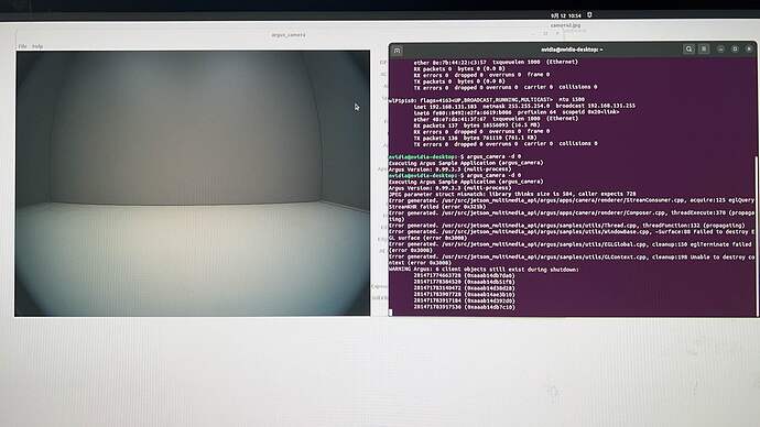

Hi NV experts,
We turned on the camera on version JP6.1 and JP6.2. We found that clicking the “Take Photo” button on the Argus interface would cause the system to freeze. Could someone please help us investigate this issue? Thank you.

    • Issue 4685929: There may be issues while running argus_camera with the error “JPEG parameter struct mismatch: library thinks size is 584, caller expects 728”.

hello Cherry123,
it looks like known issue, please see-also r36.4 release note for [2.3. Camera] section.
please give it a try with below workaround to use PRELOAD command before running argus_camera application.
for instance,
$ export LD_PRELOAD=/usr/lib/aarch64-linux-gnu/nvidia/libnvjpeg.so
