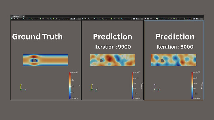

Hello @abouzar.ghasemi,
I’ve tried saving the fine-tuned model at every 100 iteration like in code written in train.py, but the inference results still don’t match expectations. Below is how I’m saving the model during fine-tuning and the method I’m using for inference.
Saving Finetuned Model Code :

    * def save_checkpoint1(self, iteration: int, checkpoint_dir: str = "./workspace/checkpoints"):*
*        os.makedirs(checkpoint_dir, exist_ok=True)*
*        checkpoint_path = os.path.join(checkpoint_dir, f"finetuner_iter_{iteration}.pt")*
*        save_dict = {*
*            'iteration': iteration,*
*            'model_state_dict': self.model.state_dict(),*
*            'optimizer_state_dict': self.optimizer.state_dict(),*
*            'scheduler_state_dict': self.scheduler.state_dict(),*
*        torch.save(save_dict, checkpoint_path)*
*        print(f"Checkpoint saved at iteration {iteration} to {checkpoint_path}")*

            **if iters > 0 :**
**                pi_fine_tuner.save_checkpoint1(iteration=iters,checkpoint_dir="./workspace/checkpoints")**
**            save_checkpoint(**
**                to_absolute_path(cfg.finetune_ckpt),**
**                models=pi_fine_tuner.model,**
**                optimizer=pi_fine_tuner.optimizer,**
**                scheduler=pi_fine_tuner.scheduler,**
**                epoch=cfg.pi_iters,**
    logger.info("Physics-informed fine-tuning training completed!")
    # # Save the model state
    # model_save_path = os.path.join(to_absolute_path(cfg.results_dir), "pi_fine_tuner.pt")
    # torch.save(pi_fine_tuner.model.state_dict(), model_save_path)
    # logger.info(f"Model saved at {model_save_path}")
    # Save results
    # Final inference call after fine-tuning predictions using the PINN model
    with torch.no_grad():
        out = pi_fine_tuner.model(dgl_graph.ndata["x"], dgl_graph.edata["x"], dgl_graph)
        results_int_inf = {k: out[:, i : i + 1] for i, k in enumerate(["u", "v", "p"])}
        pred_u_inf, pred_v_inf, pred_p_inf = (
            results_int_inf["u"],
            results_int_inf["v"],
            results_int_inf["p"],
        pred_u_inf = pred_u_inf.detach().cpu().numpy()
        pred_v_inf = pred_v_inf.detach().cpu().numpy()
        pred_p_inf = pred_p_inf.detach().cpu().numpy()
        polydata = pv.read(path)
        polydata["filtered_u"] = pred_u_inf
        polydata["filtered_v"] = pred_v_inf
        polydata["filtered_p"] = pred_p_inf
        print(path)
        polydata.save(path)
    logger.info("Inference completed!")
if __name__ == "__main__":
    main()

    def __init__(self, cfg: DictConfig, logger):
        self.logger = logger
        self.cfg = cfg
        self.device = "cuda" if torch.cuda.is_available() else "cpu"
        # Recreate model architecture exactly as in physics-informed training
        self.model = MeshGraphNet(
            cfg.input_dim_nodes+128 ,  # Must match training (+128 for Fourier features)
            cfg.input_dim_edges,
            cfg.output_dim,
            aggregation=cfg.aggregation,
            hidden_dim_node_encoder=cfg.hidden_dim_node_encoder,
            hidden_dim_edge_encoder=cfg.hidden_dim_edge_encoder,
            hidden_dim_node_decoder=cfg.hidden_dim_node_decoder,
        ).to(self.device)
        # Load saved weights
        # model_path = os.path.join(to_absolute_path(cfg.results_dir), "finetuner_iter_9900.pt")
        # self.model.load_state_dict(torch.load(model_path, map_location=self.device))
        # Load saved weights correctly
        checkpoint = torch.load(model_path, map_location=self.device)
        self.model.load_state_dict(checkpoint["model_state_dict"])
        self.model.eval()
        # self.logger.info(f"Loaded physics-informed model from {model_path}")
    def process_input(self, input_path):
        """Load and preprocess input data to match training format"""
        # Reuse dataset loading function from training
        _, _, _, _, _, _, coords, coords_inflow, _, _, _, nu, dgl_graph = get_dataset(
            input_path, return_graph=True
        # Move graph to device
        dgl_graph = dgl_graph.to(self.device)
        return dgl_graph, coords, nu
    def run_inference(self, input_path, output_path):
        """Run model inference on new input file"""
        # Load and preprocess data
        dgl_graph, coords, nu = self.process_input(input_path)
        # Run inference
            out = self.model(
                dgl_graph
            print("Inference output shape:", out)
            print("Results keys:", results_int_inf)
            print("Predictions shapes:", pred_u_inf, pred_v_inf, pred_p_inf)
            print("Converted predictions to numpy arrays")
            print("Predictions shapes after conversion:", pred_u_inf, pred_v_inf, pred_p_inf)
            polydata = pv.read(input_path)
            print(input_path)
            polydata.save(input_path)
        self.logger.info("Inference completed!")
        # pred_u, pred_v, pred_p = out[:, 0], out[:, 1], out[:, 2]
        # # Convert to numpy
        # pred_u = pred_u.cpu().numpy()
        # pred_v = pred_v.cpu().numpy()
        # pred_p = pred_p.cpu().numpy()
        # # Save results
        # polydata = pv.read(input_path)
        # polydata["f_u"] = pred_u
        # polydata["f_v"] = pred_v
        # polydata["f_p"] = pred_p
        # polydata.save(output_path)
        # self.logger.info(f"Saved predictions to {output_path}")
@hydra.main(version_base="1.3", config_path="conf", config_name="config")
def main(cfg: DictConfig) -> None:
    logger = PythonLogger("physics_informed_inference")
    logger.file_logging()
    logger.info("Starting physics-informed inference")
    # Initialize inference engine
    inference_engine = PhysicsInformedInference(cfg, logger)
    # Process input file
    input_file = to_absolute_path("graph_8.vtp")
    output_file = to_absolute_path("predictions.vtp")
    inference_engine.run_inference(input_file, output_file)
    logger.info("Inference completed successfully")
    main()
Questions :
  1. Why after finetuning the model the example not saving it?
  2. How to inference the save finetuned model
Thankyou for support !
