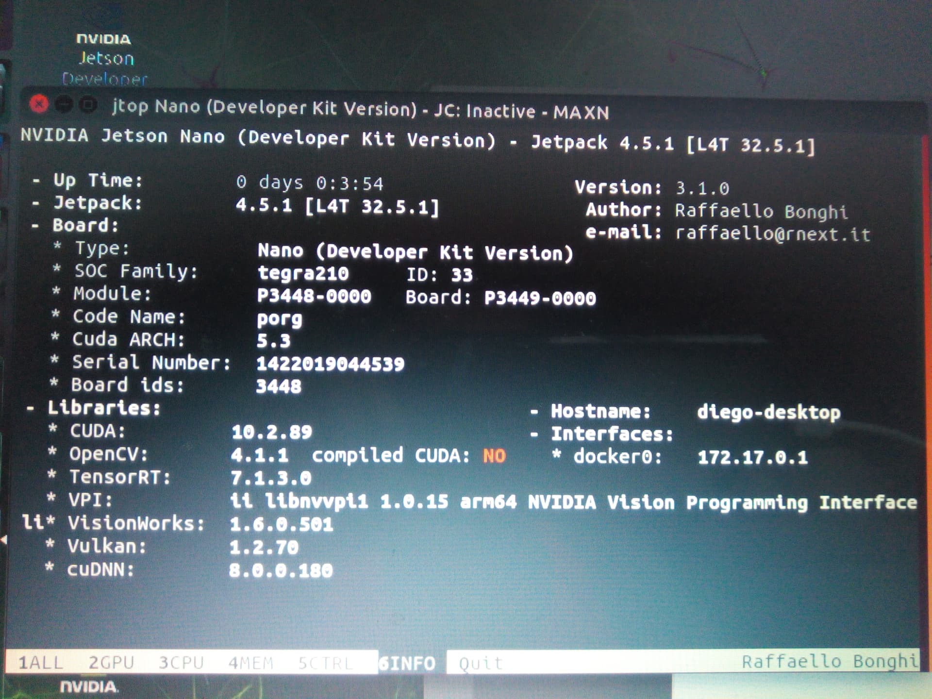

Jetpack 4.5 l4t 32.5.1 core dump at python3 'import' command in Jetson NANO
intro python3 at any request import whatever… get out of python and message ‘illegal instruction (core dumped)’
Attach photos.

This is a known issue from the NumPy module.
Would you mind reinstalling the NumPy v1.19.1 and try it again?
$ pip3 install numpy==1.19.1
