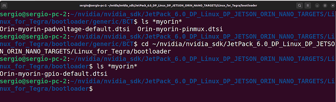

Saved the generated gpio, pinmux and padvoltage files:
Orin-myorin-.zip (7.4 KB)

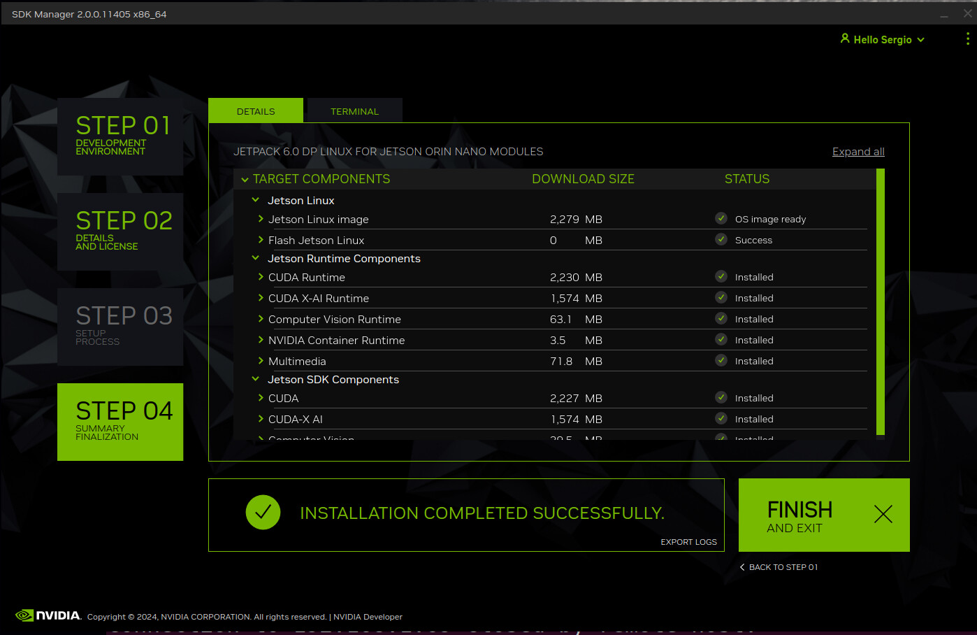

Flash in Automatic without Runtime and SDK components:
Restart Jetson and let ubuntu apply changes.

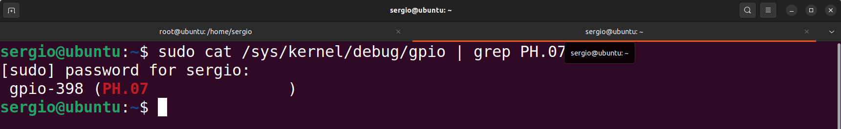

  1. At jetson start:
    sergio@ubuntu:~$ sudo cat /sys/kernel/debug/gpio | grep PH.07
    [sudo] password for sergio:
    gpio-398 (PH.07 )

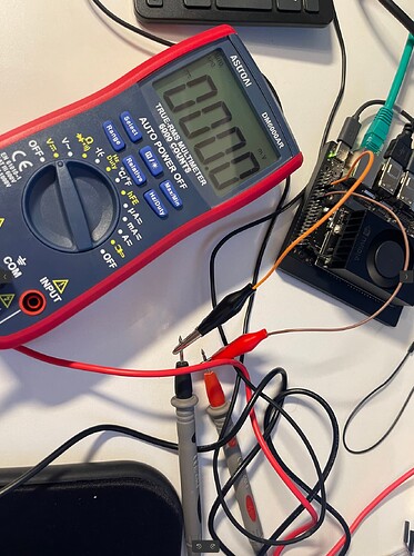

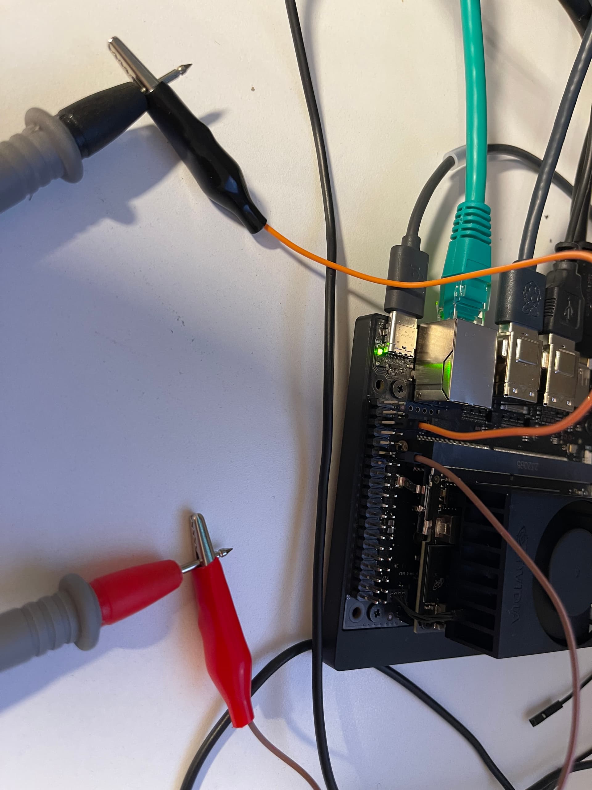

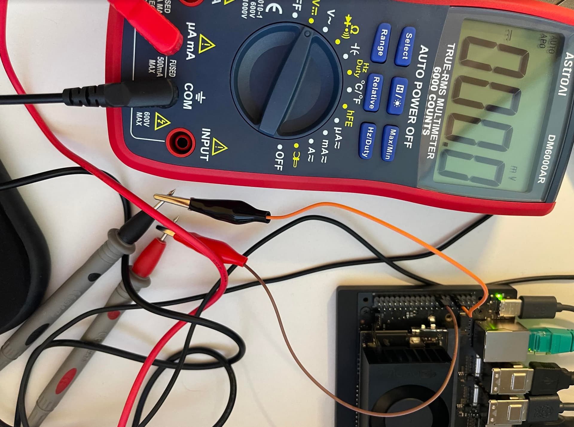

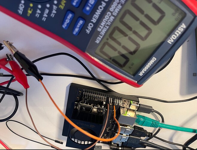

  3. Try Multi meter - no DC voltage:
From your multi meter, it seems 2.3V.
Could you try to pull it low and check if the value would become 0?
GPIO.output(led_pin,GPIO.LOW)
Hello @KevinFFF please look closer , the unit is mV = millivolts, there is no current
You could use larger scale to check the voltage.
Please disconnect the LED and just measure the voltage on PIN12(PH.07) of 40-pin expansion header.

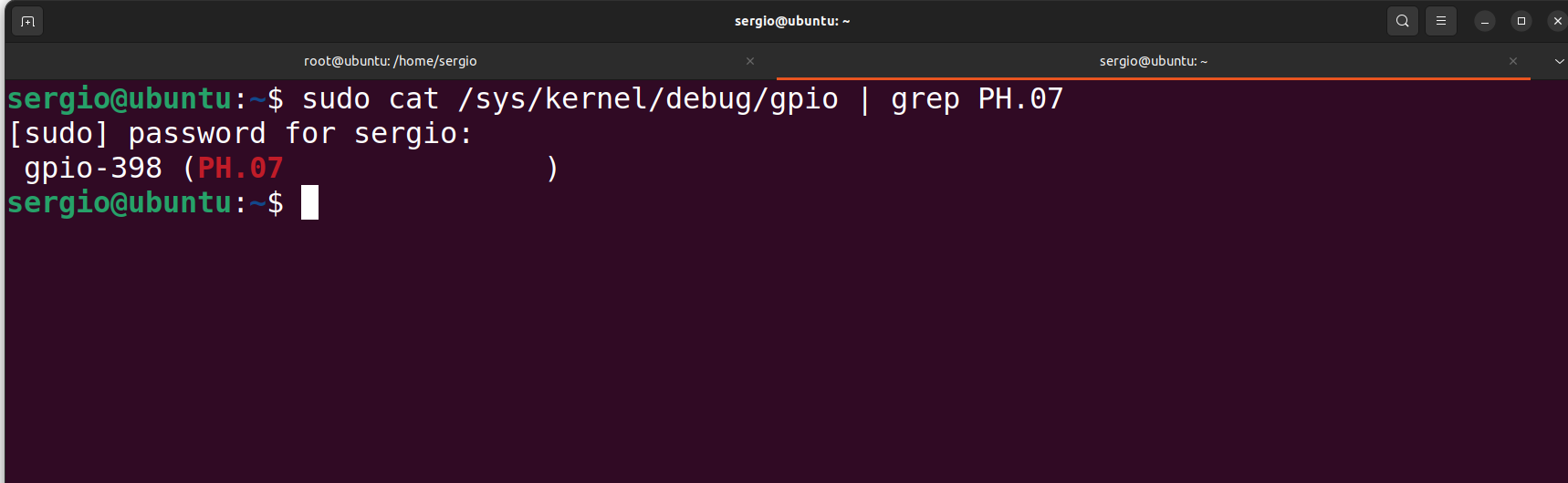

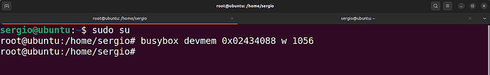

Hello @KevinFFF response is invalid offset:
  1. Before I start:
    gpio-398 (PH.07
  2. sergio@ubuntu:~$ sudo su
    root@ubuntu:/home/sergio# busybox devmem 0x02434088
    0x00001002
    root@ubuntu:/home/sergio# busybox devmem 0x02434088 w 1056
    0x00000400
  3. The command provided errored with “Invalid offset and voltage stays at zero”
    oot@ubuntu:/home/sergio# gpioset --mode=wait gpiofind “PH.07”=0
    gpioset: invalid offset<->value mapping: PH.07=0
    root@ubuntu:/home/sergio# gpioset --mode=wait gpiofind “PH.07”=1
    gpioset: invalid offset<->value mapping: PH.07=1

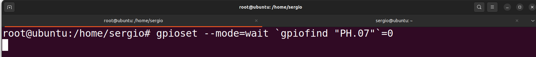

root@ubuntu:/home/sergio# gpiofind PH.07
gpiochip0 50

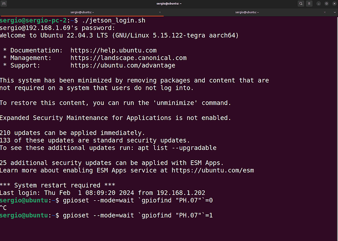

  1. Changed command to:
    root@ubuntu:/home/sergio# gpioset --mode=wait $(gpiofind “PH.07”)=1
    ^C
    root@ubuntu:/home/sergio# gpioset --mode=wait $(gpiofind “PH.07”)=0
    ^C

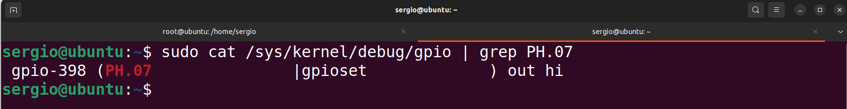

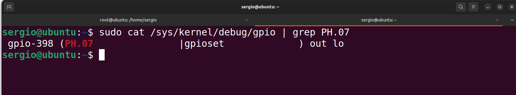

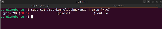

When I set “PH.07”=1 I can see:

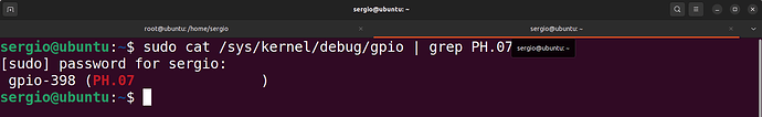

gpio-398 (PH.07 |gpioset ) out hi
When I set “PH.07”=0 I can see:
gpio-398 (PH.07 |gpioset ) out lo
However there is no current. I disconnected the LED.
Please let me know what I can look into.
Thank you.
This is the step what I’ve verified on the devkit and should work.
You didn’t add ` for gpiofind “PH.07” here.
It is " rather than and
Do you have any custom modification in pinmux with the clean R36.2?
In my case, I got 0x1456 after flash the board.
The bit 10 should be 0 for GPIO usage so that I configured 0x1056 for this register.
0x400 is also not the expected value for this pinmux register.

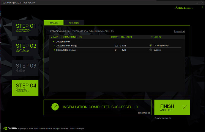

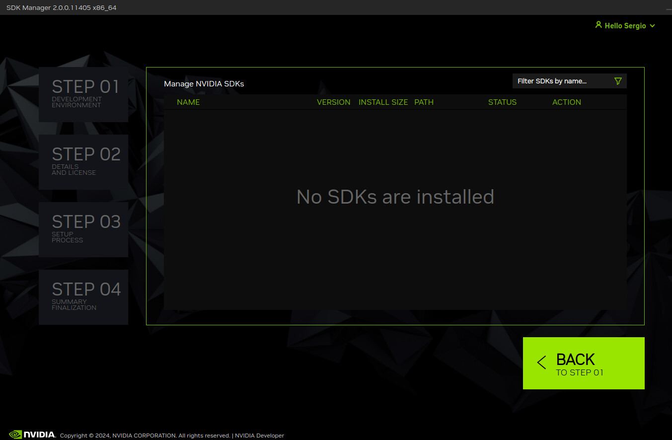

Since you are using the devkit, I would suggest you could verify from clean JP6.0 DP (R36.2).
You could just use SDKM to flash clean R36.2.
and run the commands what I’ve also verified on the devkit, too.

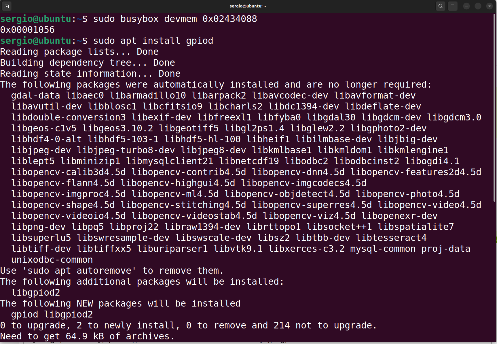

$ sudo busybox devmem 0x02434088
(please share the result)
$ sudo apt install gpiod
$ sudo su
# gpioset --mode=wait `gpiofind "PH.07"`=0
# gpioset --mode=wait `gpiofind "PH.07"`=1

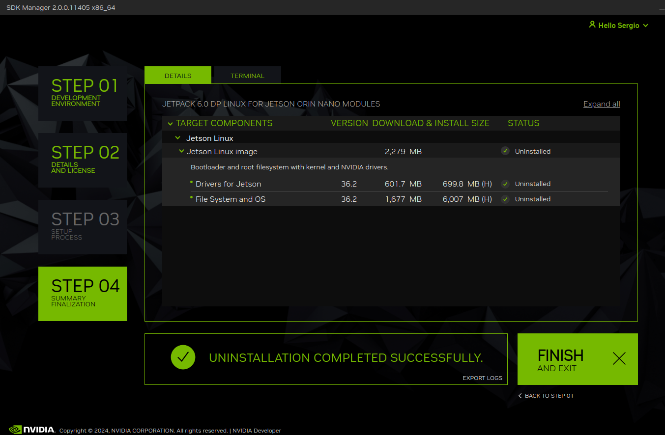

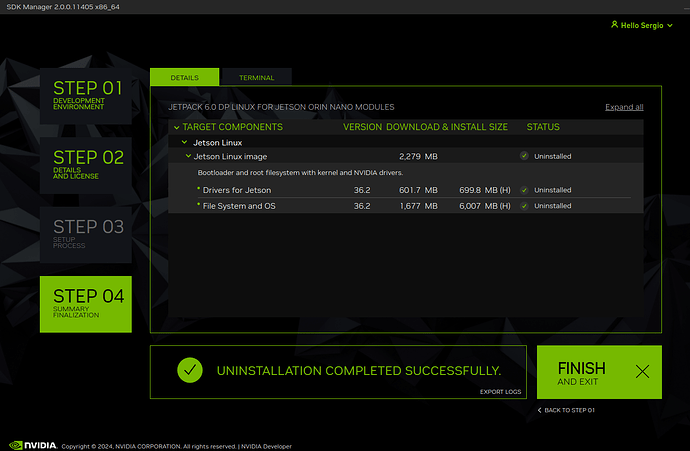

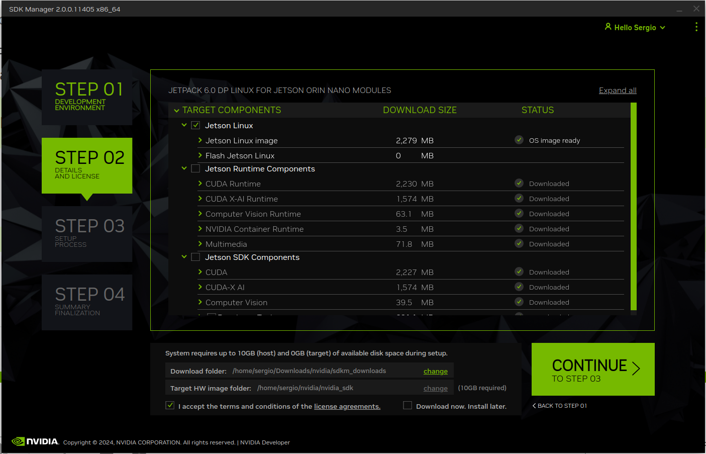

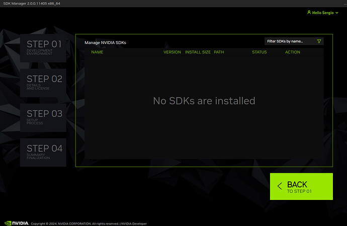

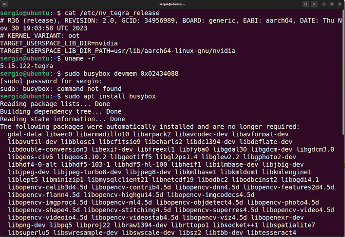

Hi @KevinFFF
OK I have uninstalled the existing image and installed fresh clean R36.2
Version installed:
Devmem requested:

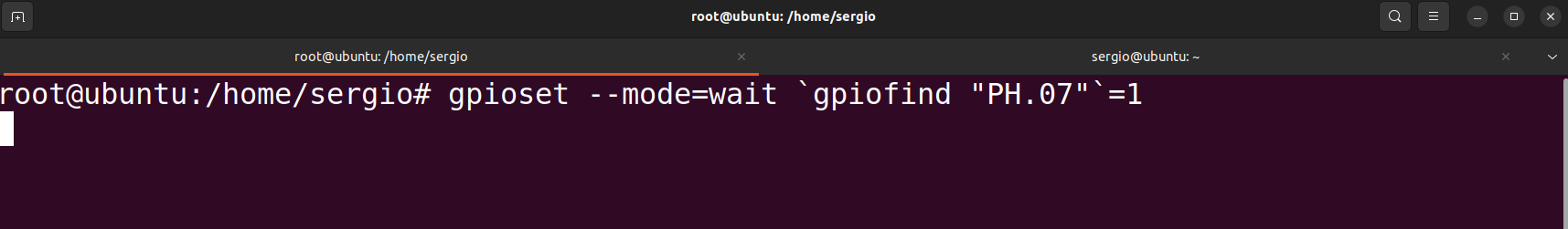

Write to devmem:
Check gpio:
Set gpio to 0:
Set GPIO to 1:

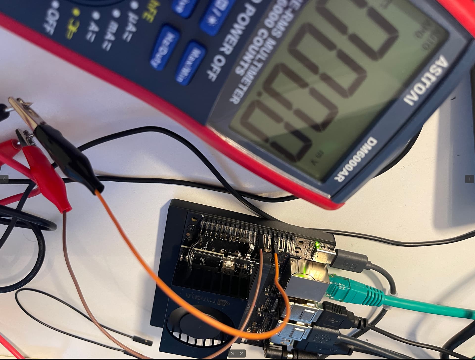

No Current PIN 15:
Please advise steps to RMA.
You should write 0x1056 rather than 1056…
Let me show you the difference:
root@Jetson:# sudo busybox devmem 0x02434088
0x00001056
root@Jetson:# sudo busybox devmem 0x02434088 w 1056
0x00000400
root@Jetson:# sudo busybox devmem 0x02434088 w 0x1056
0x00001056
Hello @KevinFFF
Same results as yours:
Then I try with this last w setting:
No Voltage PIN 15:
Please advise steps for RMA.
