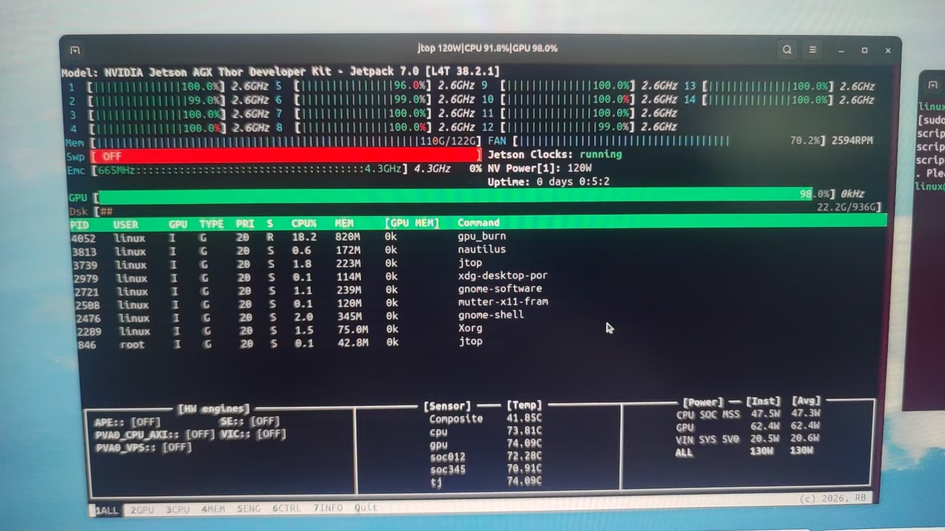

JetPack7.2 r39.2 T5000 GPU 功耗跑不满
我们在同一块主板上适配了 r38.2 和 r39.2 :
r38.2 GPU 功耗可以到 60W
r39.2 GPU 功耗只能到 40W
压测指令都是:
nvpmodel -m 0
jetson_clock
stress-ng --cpu 14 --cpu-method fft &
./gpu_burn -tc 1000000
请问这个是什么原因?有排查思路吗?
另外问一下 r39.2 多出来的 Sensor 1 是什么?

请问这个问题有排查思路吗?是否是 BPMP 固件更新导致的?
Could you share the gpu_burn test so we can check it internally?
GitHub - wilicc/gpu-burn: Multi-GPU CUDA stress test · GitHub
从 github 下载编译
Thanks for the update.
We will test this internally and provide more information to you later.
Test the stress commands below with 120W mode (according to your jtop image).
$ ./gpu_burn -tc 1000000
$ stress-ng --cpu 14 --cpu-method fft
We can reach more than 120W without issue.
Could you re-try the test again?
@AastaLLL
Upgrade your jtop
curl -LsSf https://raw.githubusercontent.com/rbonghi/jetson_stats/master/scripts/upgrade-jtop.sh | bash
Is this issue related to jtop?
