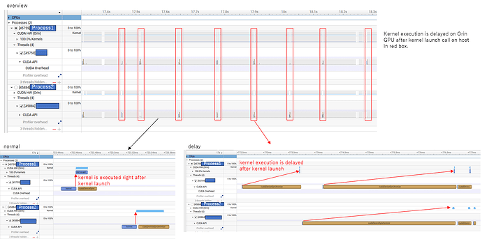

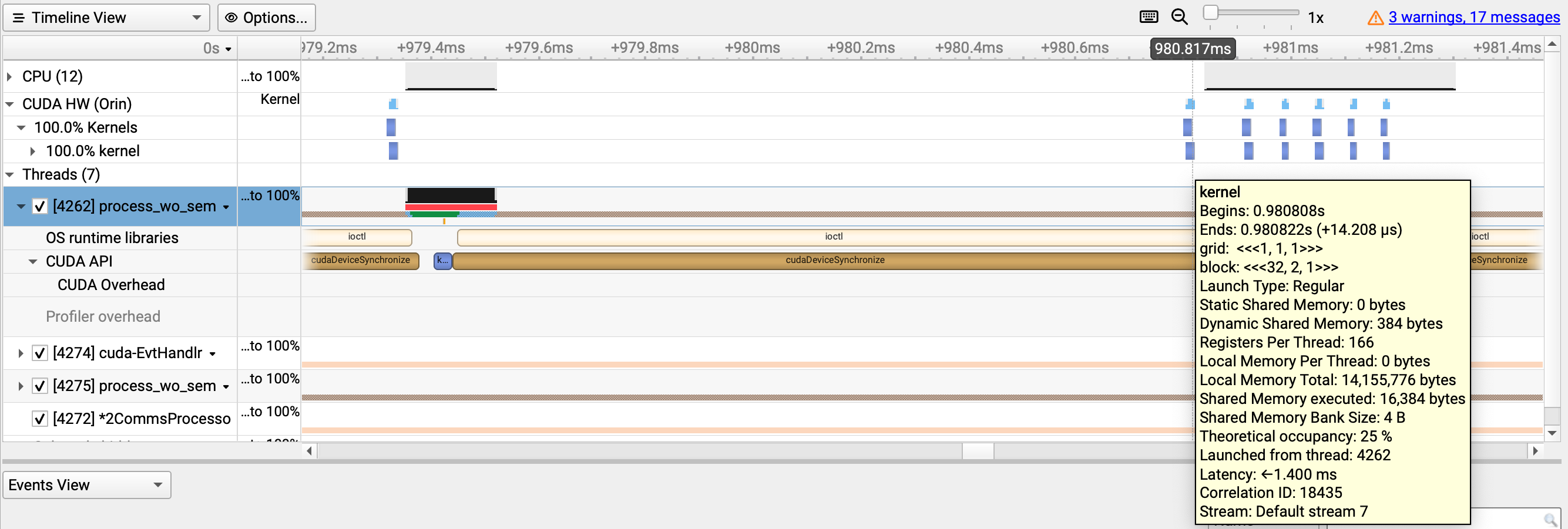

I am using iGPU on Jetson AGX Orin for Matrix Vector Multiplication.

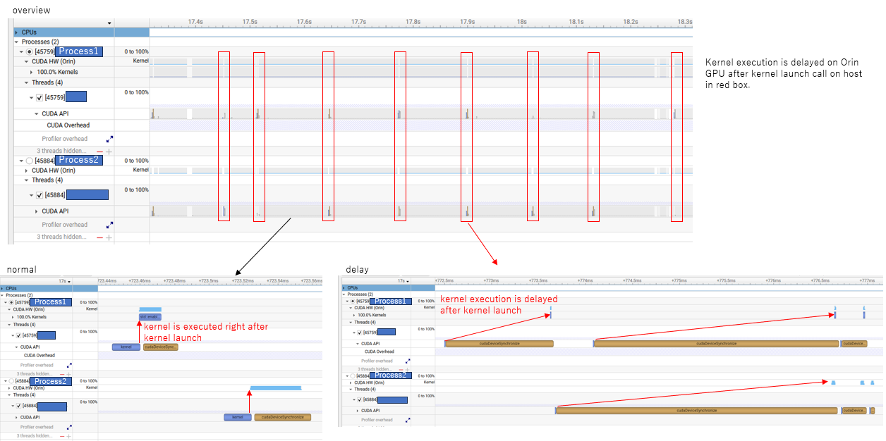

Issue is captured in below pictures from nsys.
Top: Overview of 2 processes using CUDA HW (Orin).
Lower-left: Kernel is executed right after kernel launch, which is normal behavior.
Lower-right: Kernel execution is delayed after kenerl launch. The delay happens frequently and appears to be approximately 100ms cyclical.
How could I stop this occurance of kernel execution delay?
Condition is:
  • Zero copy (mapped memory) is used with cudaHostAllocMapped in cudaHostAlloc(). Same issue is observed when using cudaMemcpy or unified memory.
  • sudo nvpmodel -m 0 and sudo jetson_clocks are executed.
  • MPS is enabled.

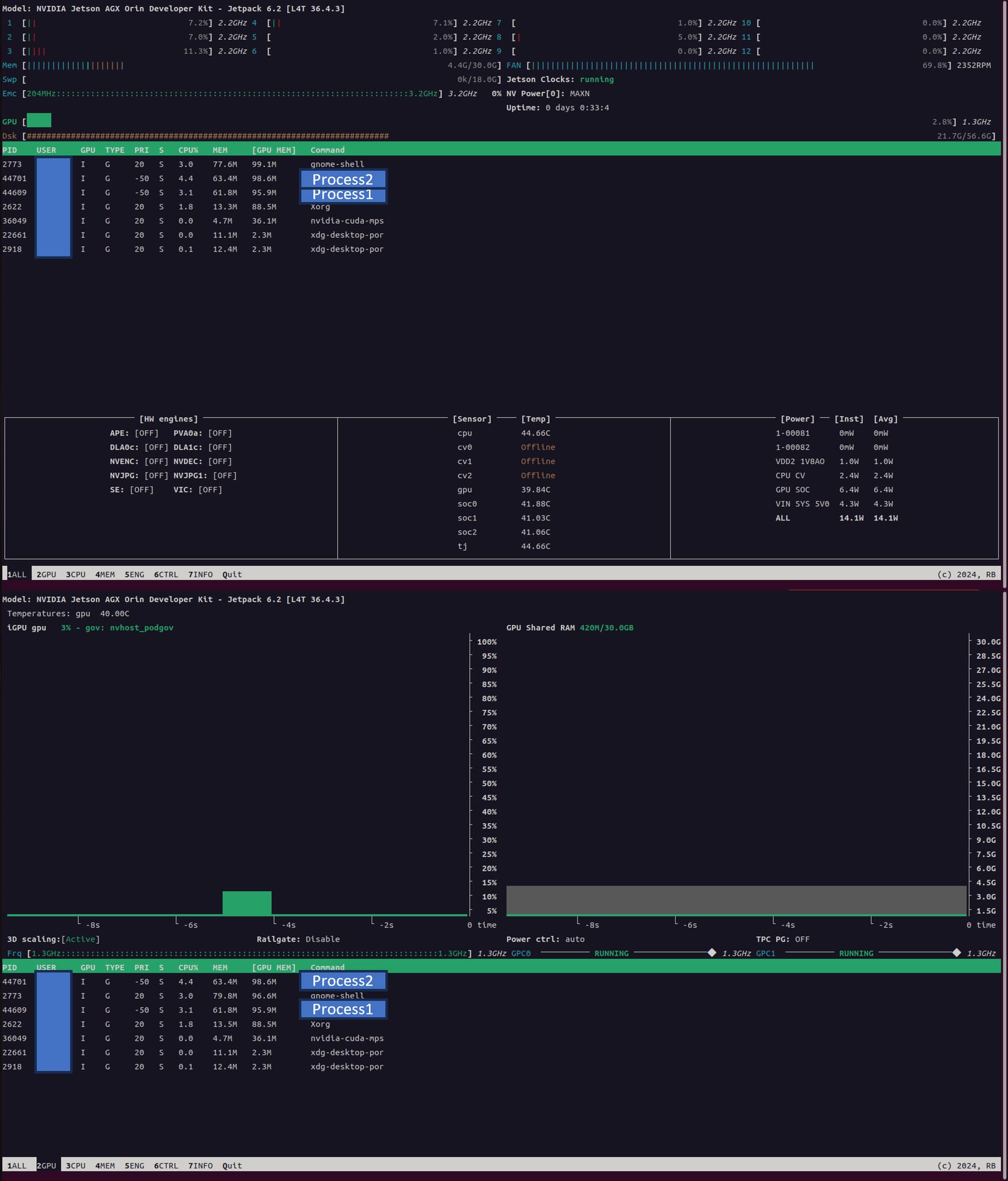

Hi @AastaLLL ,
As far as I checked with jtop, GPU is not fully occupied.
There is still resource for GPU as well as memory.
In my application, cublassSgemv() is used for Matrix Vector Multiplication.
The same issue is observed when reducing the size of matrix and vector (just 4x2 matrix and 2x1 vector).

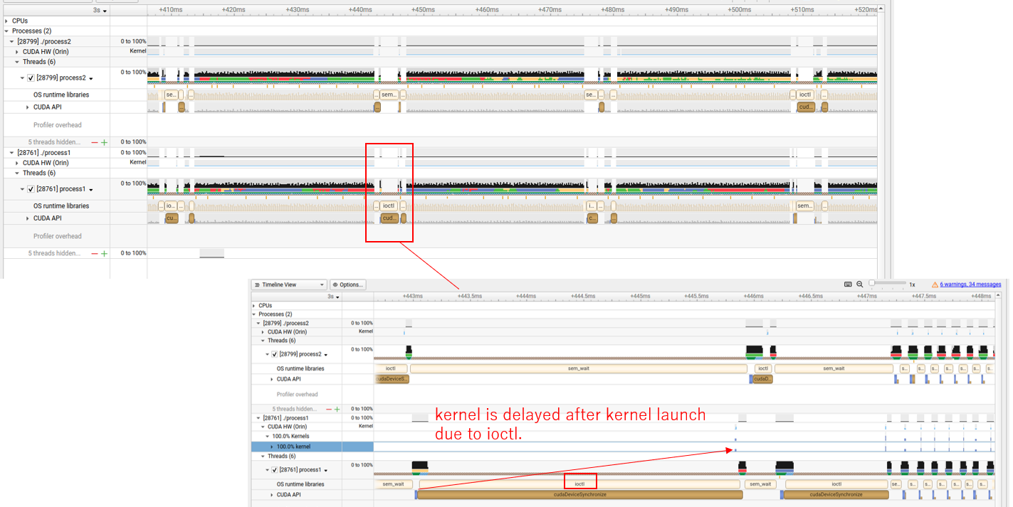

I tried with simple application that does similar to the original application.
From nsys report ioctl appears to block kenel execution after kernel launch periodically.
What is ioctl running for periodically and is there any way to stop it?
Reproducible source is packed in below attachment.
source.zip (2.8 KB)

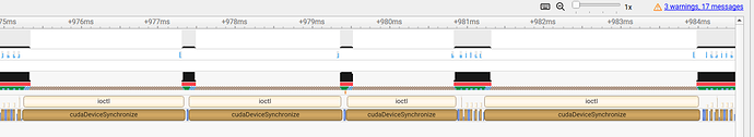

Yes, the same issue is observed without MPS too.
Similar issue is reported in below as well
When executing cuda API occasionally, ioctl blocks for tens of milliseconds - CUDA / CUDA NVCC Compiler - NVIDIA Developer Forums
If the same issue also occurs without MPS, could you share the source without using it?
Hi @AastaLLL ,
I runned only one process without MPS.
Blocks by ioctl are observed.
Could you help to check?

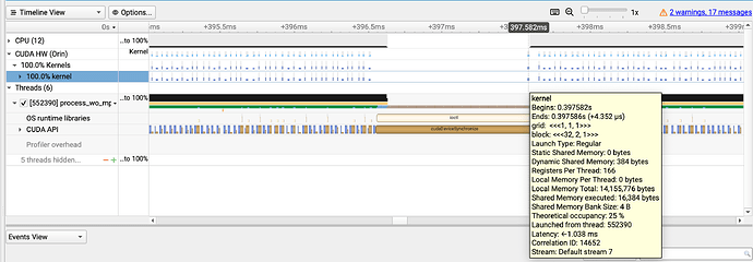

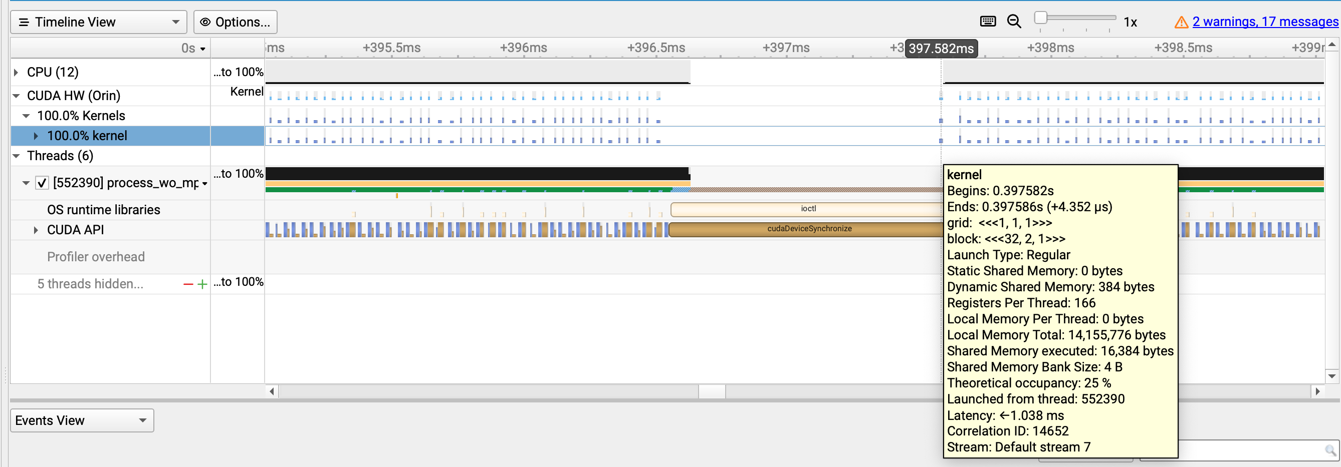

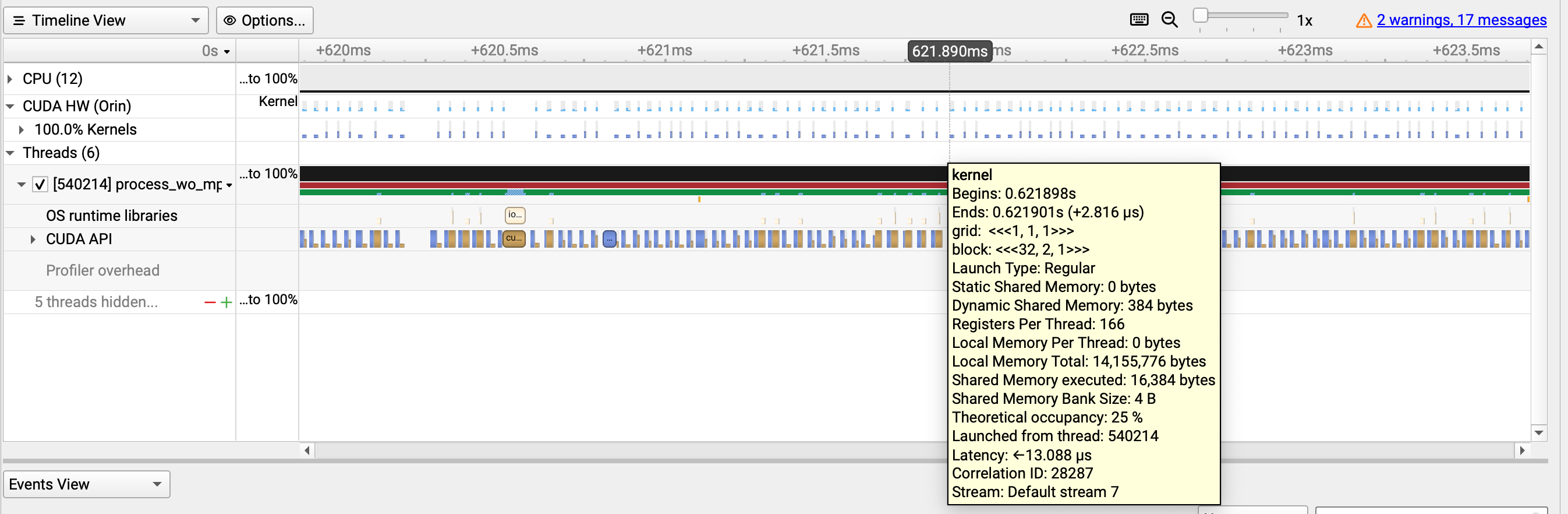

We double-checked the source and the profiling output shared on Apr 9.
Setting CUDA_DEVICE_MAX_CONNECTIONS does help.
The below experiment is done with the non-MPS sample.
Before increasing the max queue number, we do see the launch latency increase from ~12 µs to 1ms.
This matches the value of the nsys output you shared on Apr 9.
Once we set CUDA_DEVICE_MAX_CONNECTIONS to 32 (the maximum number).
The periodically long latency disappears which is always around 11µs-13µs.
We also validate the same with the MPS sample and the launch latency is around 13x µs.
Attaching nsys output with default and 32 max queue numbers for your reference.
process_wo_mps_default.nsys-rep (1.3 MB)
process_wo_mps_queue32.nsys-rep (1.3 MB)

Using tracing tool like strace, I found that Xorg and gnome-shell are calling ioctl() system call, which can be processes interrupting my application.
Setting up jetson with CUI mode disables those applications using GPU for GUI, and worked to reduce latency due to ioctl().
