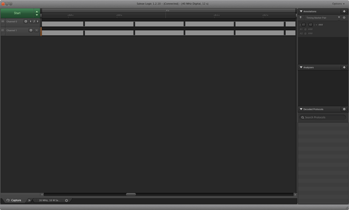

Ping was just another example to illustrate that every 100ms, core 0 appears to be busy doing something for approximately 3/4 ms.
Toggling GPIOs is a better example, see attached picture from signal analyser.
Main point is that, after running jetson_clocks.sh. Core 0 on the TX1 appears to be blocked for ~3ms every 100ms.
Disabling cores 1,2,3 is just used to illustrate the problem better so that the toggleGpio app runs on core 0 and the gaps can be seen in the signal analyser.

If you hover your mouse over the upper right corner of an existing post where the “edit” (looks like a pencil) icon is, then a “paper clip” icon will show up. This is how you attach to an existing post (you can’t attach at the same time you create a post).
Btw, I think the ethernet controller on the TX1 goes through a USB controller, and there are some peripherals which scan at a 100Hz polling rate (though I think most of the modern world has moved to 1000Hz…and optionally 250Hz). It’s entirely a guess, but it is possible that you are seeing USB polling.
Ok, finally found out the delay in your log. Something like below one, right?
[1546511906.607268] 64 bytes from 192.168.2.22: icmp_seq=294 ttl=63 time=<b>3.86 ms</b>
I am still not convinced by the test that it is a bug or issue on cpu. As I said, maybe it is indeed an issue but using “ping” from another host may not be a correct way.
There are still some possible cause for such issue. For example, power saving feature on CPU.
@linuxdev On my custom build where I also see the issue. I have seen the issue with bluetooth, usb and wifi disabled so I don’t think it is usb.
@WayneWWW I was also wondering whether it was related to the low power cores / high power cores, as the 3ms gap appears when I increase the cpu frequency OR when I max gpu frequency and turn off railgate. Could there be a power-management / frequency scaling issue that could cause this?
@WayneWWW. Have you observed a similar result?
What linuxdev wants to say is the ethernet adapter on TX1 is based on USB driver.
There are some introduction about power management in L4T document. You could read it first.
https://developer.nvidia.com/embedded/dlc/l4t-documentation-28-2-ga
I don’t think we should call it a bug at this moment. I wonder if you could use some tools like nvidia system profiler to check per core cpu utilization.
Having read power management for TX1 devices, I have tried removing CPUIDLE from kernel and device tree file, this did not fix the issue.
The issue appears to occur if:
- cpu frequency is above 1122000.
OR
2. if GPU railgate = off AND gpu frequency is above 460800000.
I will continue investigating…
akmal.ali,
As I said, there are still other processes running in background if you are using L4T BSP directly from jetpack. How could you prevent such case influences your observation?
More importantly, does this 3ms delay affect/block any of your usecase?
You might be able to partially work around via increasing the priority of your process…try renicing it to “-2” (if you need to go more negative it isn’t going to help, but it might cause problems).
@linuxdev I tried renicing the process, this didn’t solve the issue.
@WayneWWW The usecase is a real-time application with low latency, so having a 3ms delay does affect our usecase. It seems that the 3ms delay also delays cuda calls despite them running on threads on other cores. I see the issue on both the L4T BSP and on our custom build which runs less unnecessary processes. The question is, that if it is a process, do you have any idea which one it could be.
The issue presents itself when gpu OR cpu clocks are increased and is affected by whether gpu railgate is set to 0 or 1. This leads me to think that it is related to the clock / power system. Unfortunately have not found the cause yet.
If this is related to some kind of cpu scheduling issue, we may need help from nv internal team.
To prove this is a real issue, you should give out a better usecase and prove that your usecase really gets influenced.
For example, elaborate what kind of real-time application you are using and better sharing your code with us.
Also, you should tell us why your usecase needs to run on single core cpu. It would be far better than using the result of “ping”.
