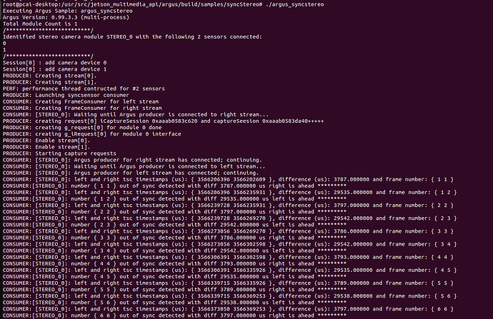

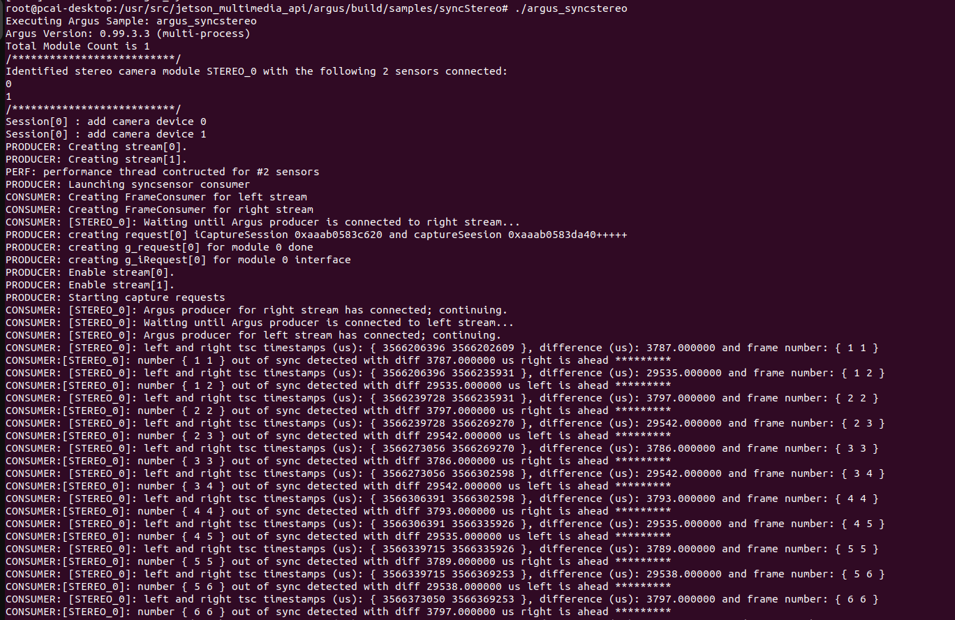

I have removed the EEPROM-related code from the program (and haven’t yet added the video-saving functionality), so this use case can run successfully.
However, I cannot see the real camera preview, and it seems that the two video streams always have a time difference of 11~22ms(We want an error within one millimeter). Could you please provide some relevant suggestions?

Looks like this sample don’t show the image only check the time diff.

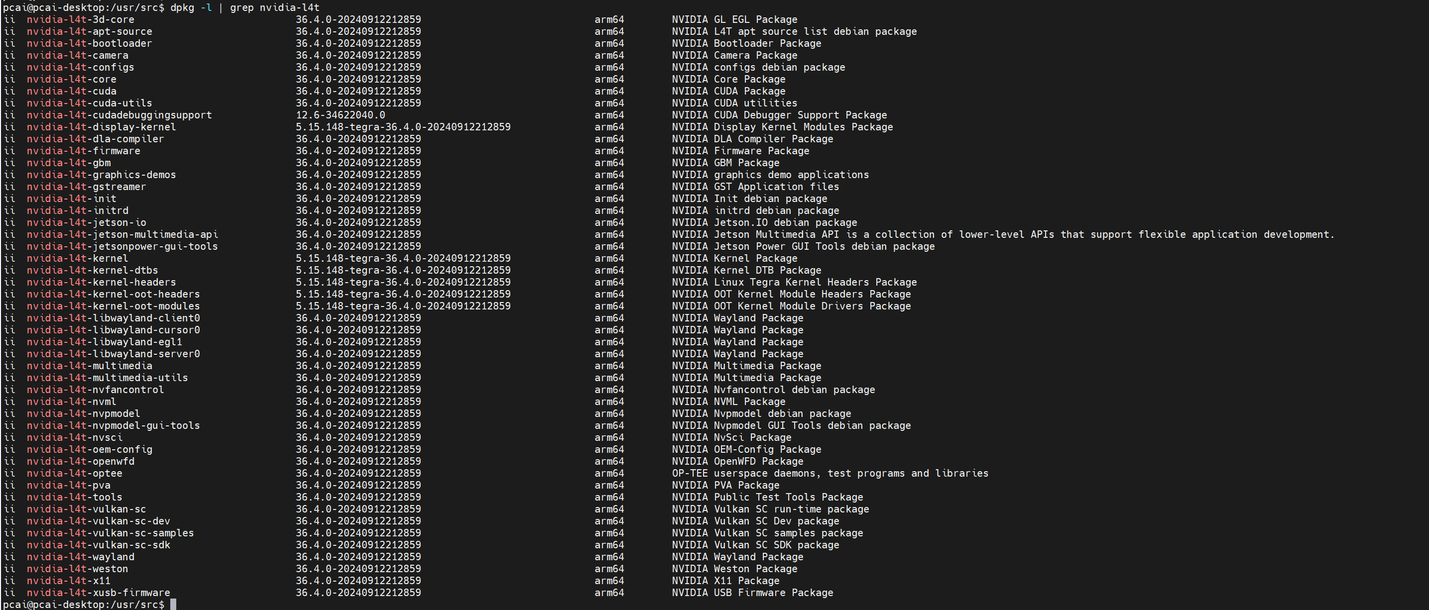

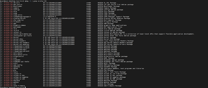

While using the API to implement the functionality I wanted, I updated the API package with the command. This has caused many library files to have inconsistent versions. Could you please tell me how to recover from this?
sudo apt-get install --reinstall nvidia-l4t-jetson-multimedia-api
I don’t have idea to recover others package but you can get the MMAPI by below command.
sudo apt list -a nvidia-l4t-jetson-multimedia-api
sudo apt install nvidia-l4t-jetson-multimedia-api=36.xxxx
Hi ShaneCCC,
It seems that using this command can revert the environment to the previous version. I’m not sure, but I’ll try again.
