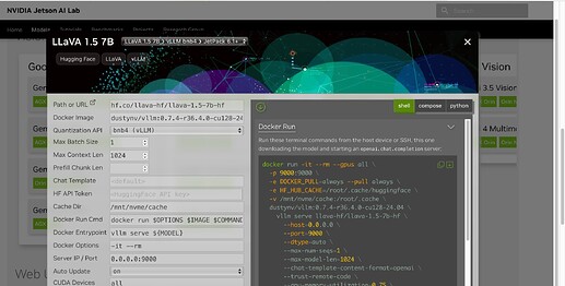

Hi All!
I am trying to use the LLaVA 1.5 7B model from Jetson AI Lab (Models - NVIDIA Jetson AI Lab), and I have a Jetson Orin Nano Jetpack 6.2, Ubuntu 22.04 and Cuda 12.6.
However, I noticed that the docker image for LLaVA requires Cuda 12.8 and Ubuntu 24.04. I have tried searching for docker images which can be used with Ubuntu 22.04 and Cuda 12.6, but I have found none so far.
Any and all help is appreciated thanks!
You can find the container info on the same page.
For example, the LLaVA model uses vllm model which you can find in the below link:
https://hub.docker.com/r/dustynv/vllm/tags
