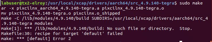

Here’s the output when I try using “make”
I tried making the directory “/lib/modules/4.9.140/build” but it says the file already exists. However, if I try to change directory to “/lib/modules/4.9.140/build” it says there is no such file or directory.
It looks like you are compiling directly on the Jetson. Correct me if I am wrong about this, but other than the possibility of running out of disk space this is the simplest build.
There are a number of steps you have to take to configure the source of a kernel build prior to actually building. I will suggest that you look at the docs for building a kernel, and that once you can “make Image” (the uncompressed kernel), then you can build any subtarget without issue. For example, if Image can build, then your particular module can be built. The error you mention is actually good since it says “make” is now working (and not trying to execute “Makefile” as a program). However, one would not modify the Makefile of kernel source, so I am suspicious of this Makefile.
