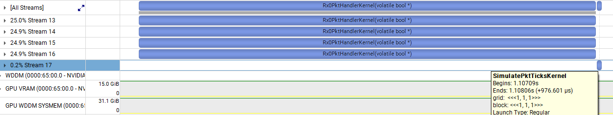

I am having issue getting different kernels to run concurrently on dedicated non-blocking cuda streams. However, the kernels run in parallel if multiple instances of the same kernel are scheduled on multiple cuda streams.
Below code has 4 persistent kernels Rx0PktHandlerKernel, Rx1PktHandlerKernel, Rx2PktHandlerKernel and Rx3PktHandlerKernel which get the data to process from a 5th kernel SimulatePktTicksKernel at a regular rate of 8.33us.
All 5 kernels are scheduled on different dedicated non-blocking cuda streams. I need all 5 kernels to run concurrently but having trouble to get that behaviour.

With the above piece of code, all 5 kernels run sequentially. See below NSYS snippet

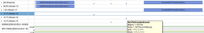

But if I call same kernel Rx0PktHandlerKernel in all 4 streams, they run in parallel with the 5th kernel SimulatePktTicksKernel starting after the first four kernels finish as it has a different name. See below NSYS snippet.
So, it appears the kernels need to be identical for them to run concurrently which is a bit odd.
What am I missing here? I have seen posts on related topic but the kernels running in parallel in all those examples are same which ties with my observations.
My question is, is there really a restriction in cuda that the kernels must be same for them to run in parallel?
