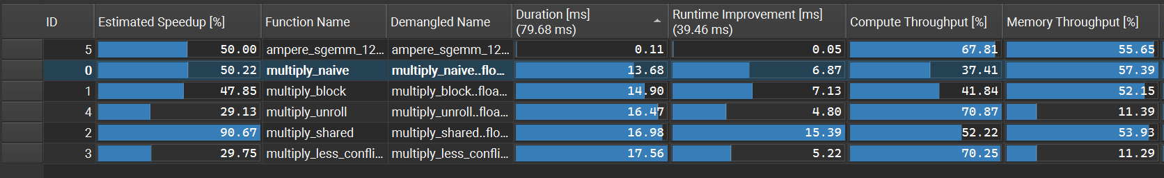

Matrix multiplication performance issue
I used some methods to optimize matrix multiplication.
Includes Naive, shared memory, less bank conflict strategy… and so on.
What confuses me much is the performance measurement.
And here is Nsight Compute analysis.
You’ll find that the naive method is apparently better than those after optimized.
I don’t know why it turns out like that…
Every output has been compared to the standard answer(generated by cpu method).

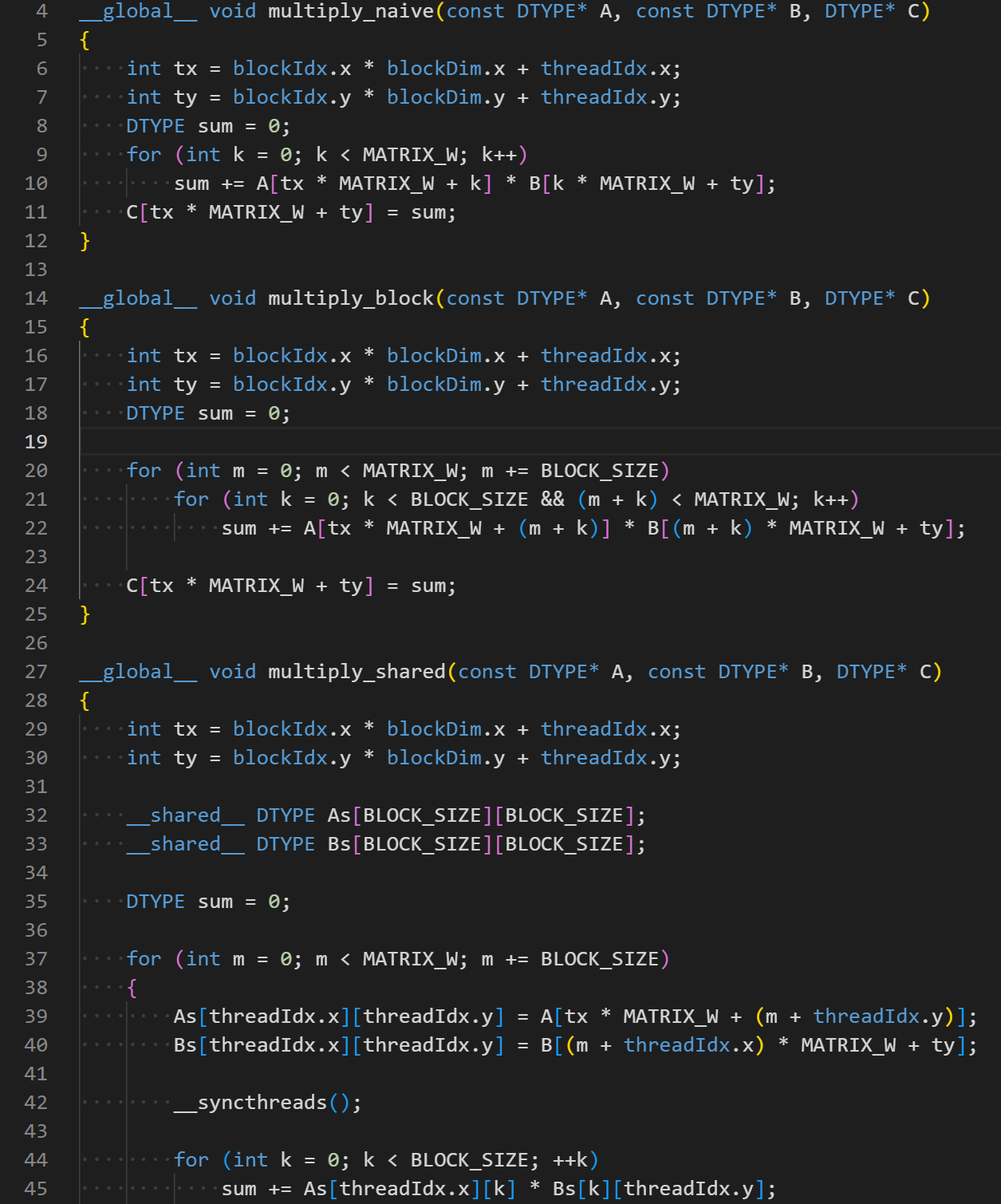

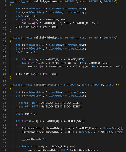

I will send my code below the topic.
My code is like this…
If you need more code segment, I will send more.
full code here

please don’t paste pictures of code on this forum. Please use the forum tools to properly format your code as text.
Paste the code into an edit window
select the code
press the </> button at the top of the edit window
save your changes.
Please fix it now.
I also recommend posting a complete code, not just the kernels.
A common error people make in these situations is to profile code that has been generated using a debug project (e.g. windows) or using the debug compilation switch (-G) for device code.
If you are doing that, it may be the explanation. If you are interested in performance analysis, you should not be compiling debug device code.
Thank you for you replying!
Turning off -Goption really works as expected.
Really sorry for troubling you because of pasting picture of code, and I would use text to send my code next time.
Thank you again for your genuine advice!

I totally understand what you mean. Even the cpu float calculation result is not accurate, right?
That’s really my fault that I regard the cpu result as the golden value.
Maybe the following result misled me:
Naive: 7 ms
(0, 0) 272445280.000000, 272445280.000000
(0, 1) 272732736.000000, 272732736.000000
(0, 2) 269240832.000000, 269240832.000000
(0, 3) 264895952.000000, 264895952.000000
(0, 4) 268468896.000000, 268468896.000000
Block: 7 ms
(1, 0) 258575440.000000, 258575440.000000
(1, 1) 259670240.000000, 259670240.000000
(1, 2) 257178240.000000, 257178240.000000
(1, 3) 259349312.000000, 259349312.000000
(1, 4) 259792512.000000, 259792512.000000
(2, 0) 274808320.000000, 274808320.000000
(2, 1) 280529408.000000, 280529408.000000
(2, 2) 277083168.000000, 277083168.000000
(2, 3) 276412352.000000, 276412352.000000
(2, 4) 281763360.000000, 281763360.000000
(3, 0) 264192432.000000, 264192432.000000
(3, 1) 265752528.000000, 265752528.000000
(3, 2) 262523520.000000, 262523520.000000
Shared memory: 8 ms
Results are perfectly the same.
Now, I thought it could just indicate that my gpu methods have same errors as cpu methods. : )
Oh, I didn’t notice that I call a host function by kernal<<<grid, block>>>(d_a, d_b, d_tmp);
That’s really an accident, and I really want to figure it out if possible.
