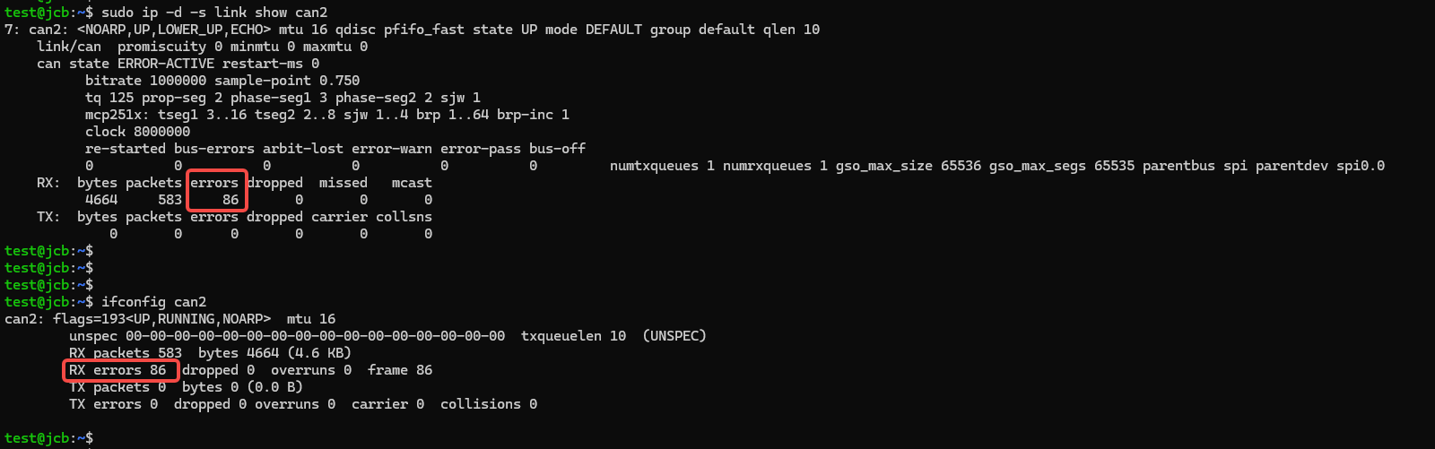

We are using the MCP2515 SPI to CAN chip and have identified an issue during testing.
When Windows sends data and the Jetson Orin receives it, the data is received normally if the transmission interval is greater than or equal to 3ms. However, when the transmission interval is less than 3ms, the received data contains errors, and frame loss occurs.

The native CAN0 and CAN1 interfaces on Jetson are unaffected; the issue occurs only with SPI to CAN.
