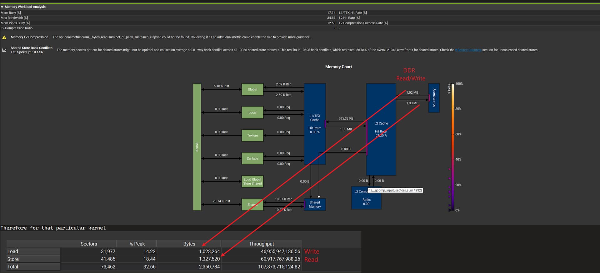

I’m working on measuring the DDR memory usage of a ResNet model running on the Orin platform, and I’d like to verify whether my measurements are accurate.
I’m profiling the resnet trt engine with
sudo /opt/nvidia/nsight-compute/2024.3.0/ncu --section SpeedOfLight --section MemoryWorkloadAnalysis_Tables --metrics group:memory__dram_table --csv /usr/src/tensorrt/bin/trtexec --loadEngine=resnet.engine --iterations=1 > resnet.csv
From what I understand the DDR is as below:
Now if I sum all the lts__t_sectors_aperture_sysmem_op_write.sum and lts__d_sectors_fill_sysmem.sum and convert it to bytes. I get something like
So the DDR BW = Total Read+Write(Bytes) /Resnet-Latency(ms). Have I misunderstood anything or is there a better way to profile this, kindly advice. Thanks in advance.

Do you want to know the bandwidth of the system?
For a particular use case, you can measure the read/write required for the app.
But for bandwidth, it is usually measured with a standalone test.
For calculating bandwidth, you can refer to our sample below:
